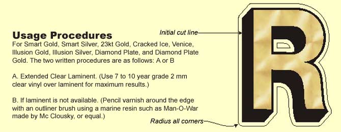

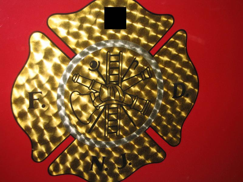

Could definitly be the Leo stuff. Thanks for that link.

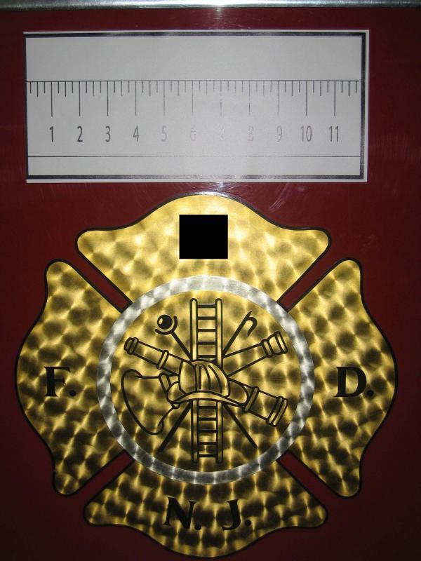

Here are a few more pics of it, you cant tell in the pics but it is definitely layered vinyl with an overlam.
natedawg9640
from what i can see. I can gaurantee that the white gold ring isn't leos and suspect the rest isn't either.... and if it is, it was custom made. In the ring, the swirls are all centered, where if it were leos, they would have cut the ring from a machine swirled piece leaving a random pattern. This also carries to the gold cross, the burnish is clearly hand swirled... not machined swirled like leos. I presume that the black cross is cut vinyl, followed byt the gold gorss laying on top of it, followed by the silver ring, and the "FD" is printed on top of clear, which is then laminated and applied over the whole thing and countour cut with a clear edge.
PM me if you have any direct questions... this is out market.
sdwnymph
there are a couple alternatives to the lam like that... one would be to use clear vinyl contoured bigger than the design and then layered on top (did this to a restaurant window design) or make the design, put all the layers together on the bottom layer (w/out removing from background paper) then laminate whole thing w/ a custom cut so at there is no vinyl under the extended lam. The clear vinyl version is the easier of the 2.
