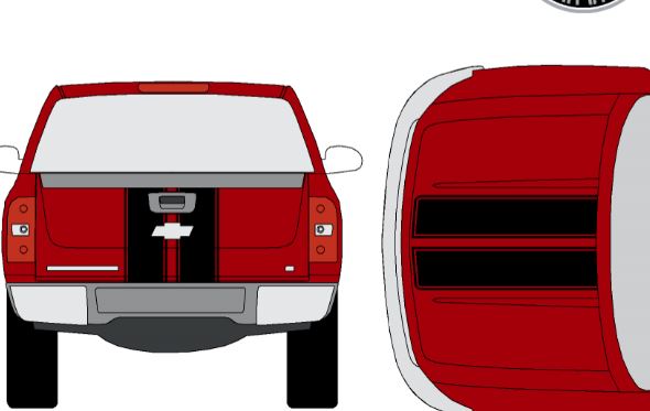

Hello! I recently opened a storefront and have three customers looking for rally stripes. I've never had a request for these before and I'm looking for some advice. I've attached a clip of the first one I plan to attack (2012 Silverado 1500). I looked for pre-made rally stripes in this style but did not find any so it looks like I'm doing these from scratch. I have quite a bit of experience with applying vehicle graphics but not rally stripes and haven't done any type of wraps either.
1. Should I use wrap vinyl for this or a regular pro-cast vinyl?
2. Do I cut around the handle and Chevy emblem or do I need to remove the emblem?
3. Any tips? Paper mask and wet apply I assume?
Thanks everyone!

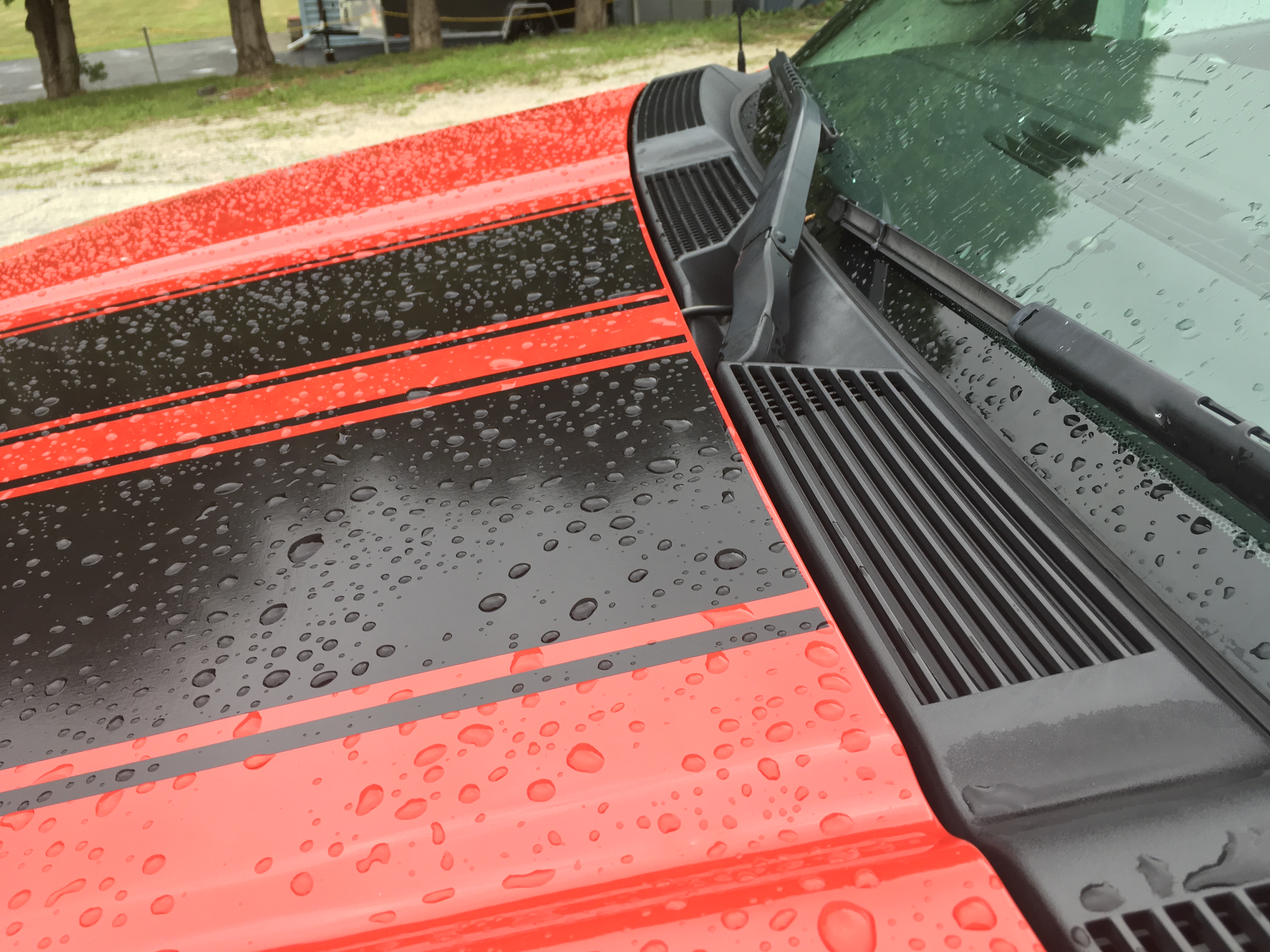

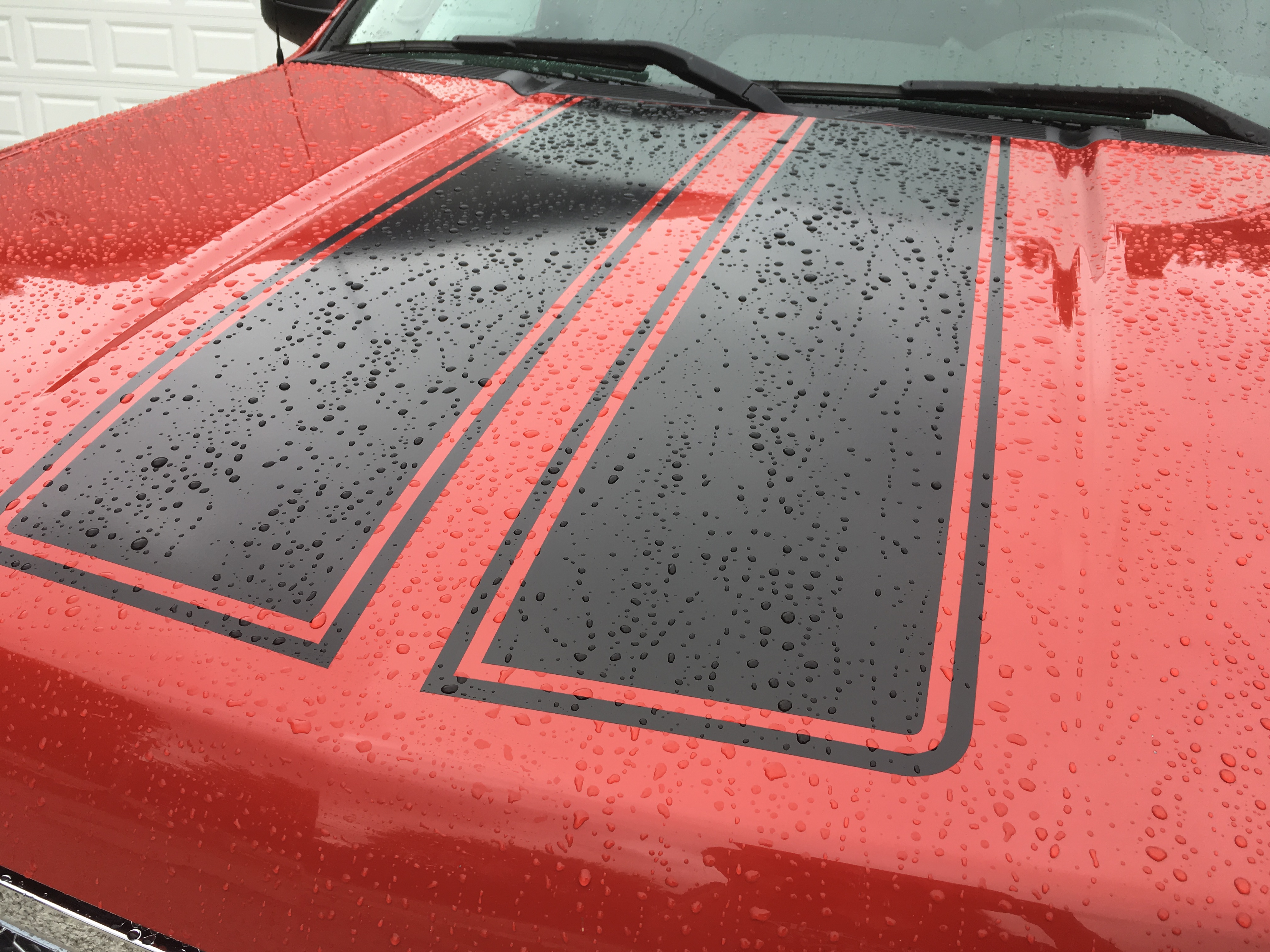

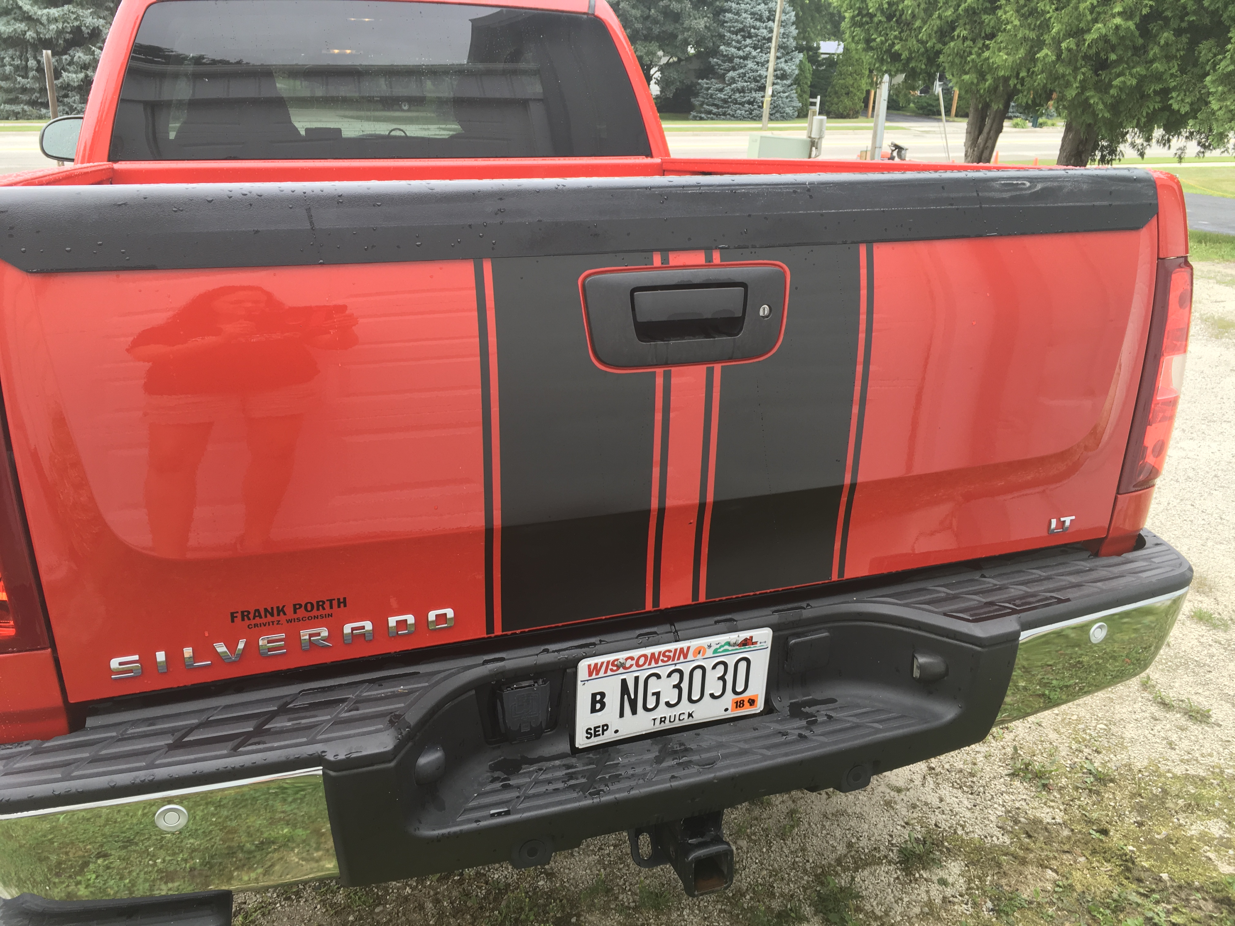

Update and another question! Thank you all for your help with these rally stripes! I learned a few things...
1. Do NOT try and cut around the emblem...it just does not work
2. Knifeless tape is the best thing since sliced bread.
3. 3M 180 is some great vinyl and dry apply with this vinyl is a breeze!
I started on the tailgate thinking I could cut around the handle and emblem...ya, that didn't work. Then I plotted around the handle and removed the emblem with some heat and fishing line. I spent the next 30 minutes removing the sticky stuff...(need a better way to do this). I cut a hole where the handle is so I had a perfectly smooth application then just had to touch up a bit around the handle. The hood went well except that I had a hard time reaching and had a couple bubbles. I waited 15 minutes for them to go down a bit then divided them into quarters and worked them out with my finger. Did I do this right? IDK but it turned out pretty good for my first try. I attached pics..it's raining...those aren't bubbles LOL
QUESTION! How do I put the emblem back on? Do I use a grease pencil and trace the emblem then cut like 1/2" in and then reapply the emblem? How much "underlap" should I leave? Thanks All!
