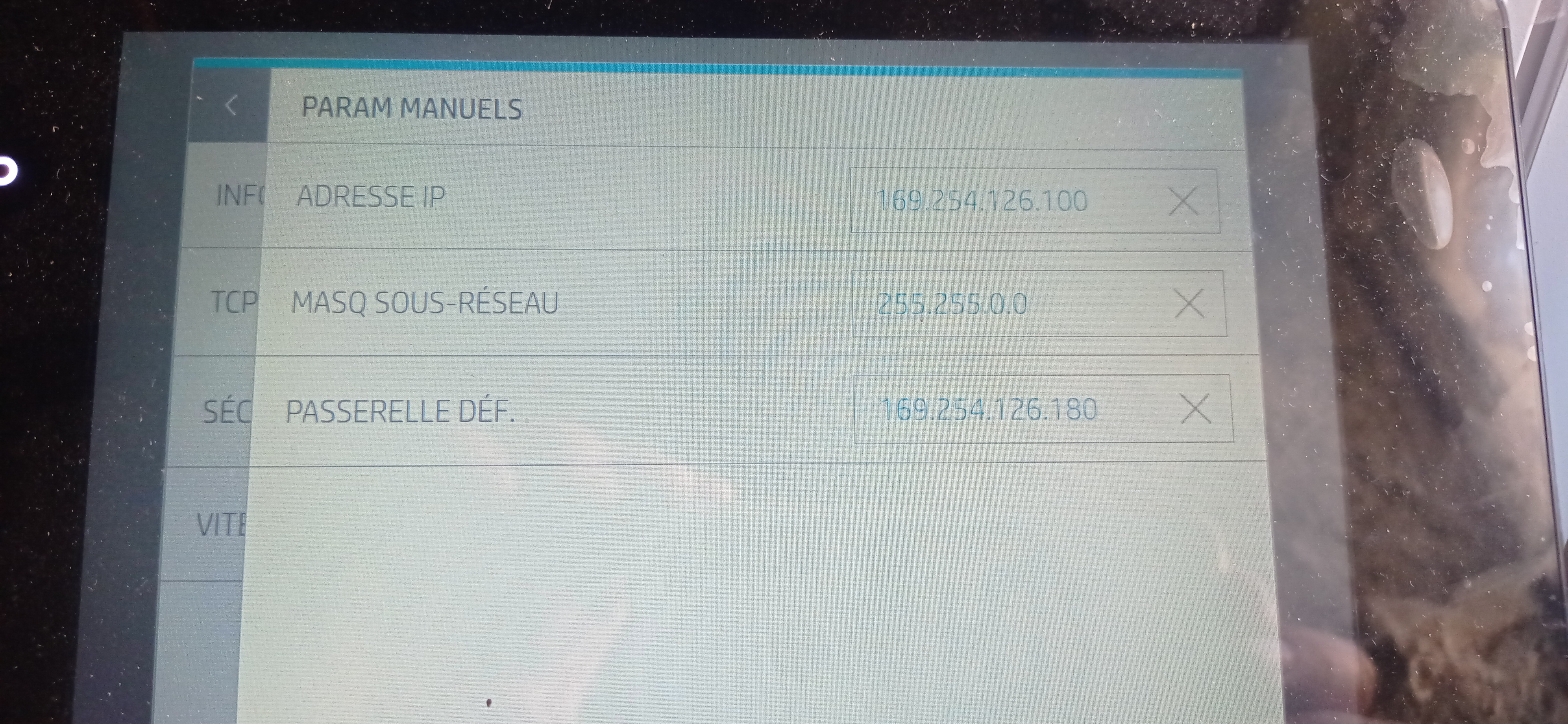

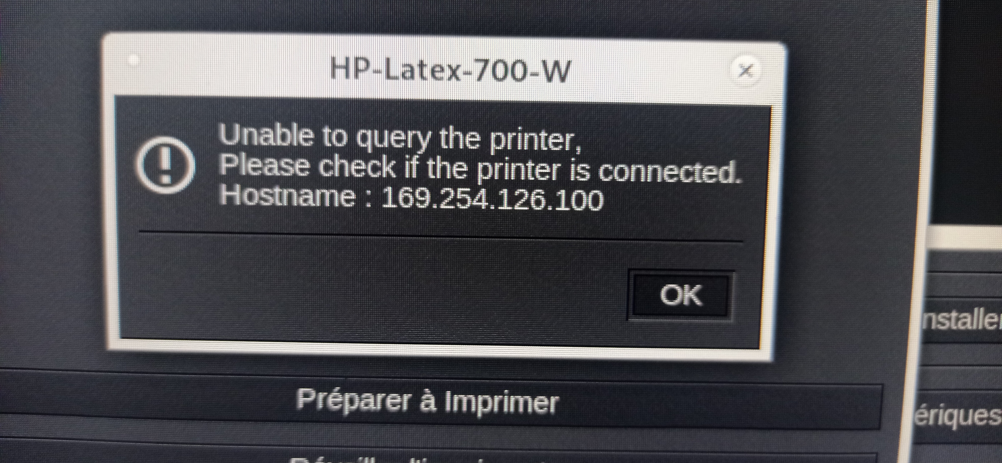

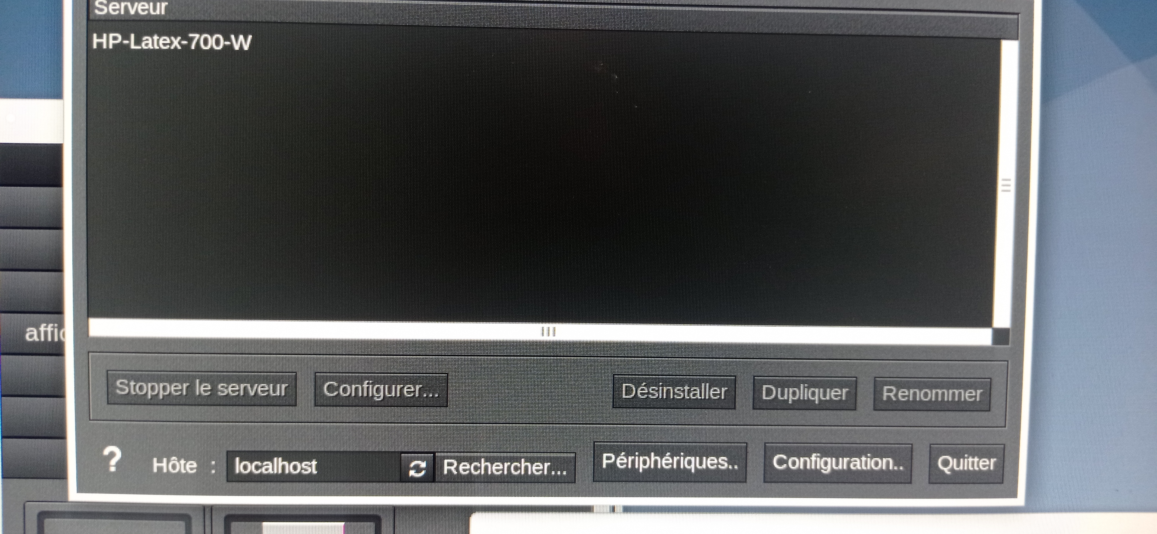

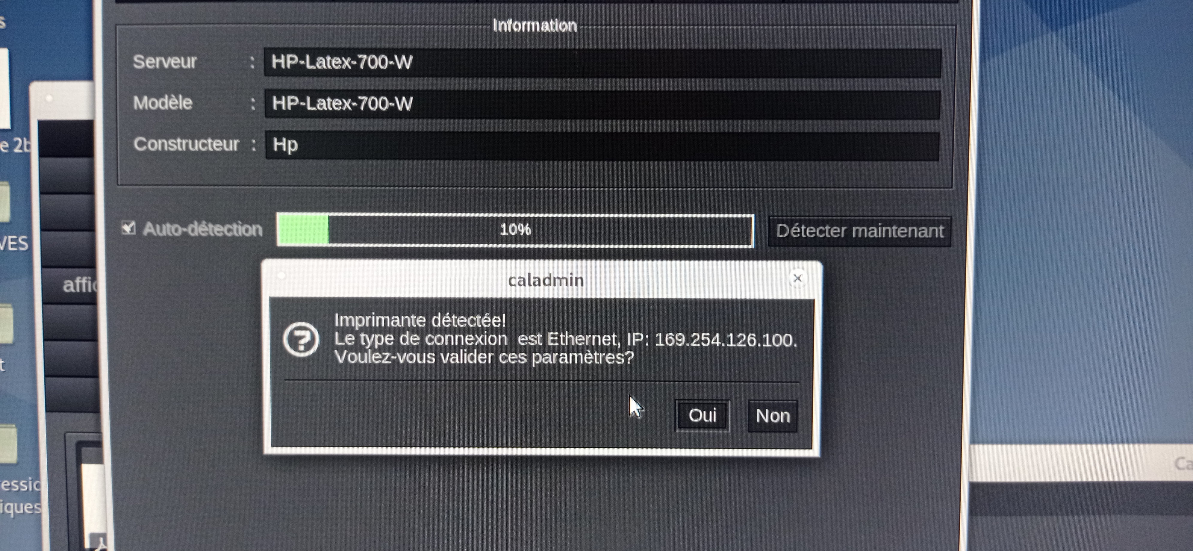

petit
Ip printer on web browser is not working, where can i disable the DHCP ? but, it actually can find the printer and start the server, caldera find the printer but when i want to go further like making an update on substract between caldera and printer or print , nothing is working. I got the message "unable to query the printer please check if the printer is connected". took screenshots of everything. THKS
