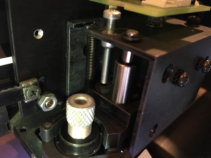

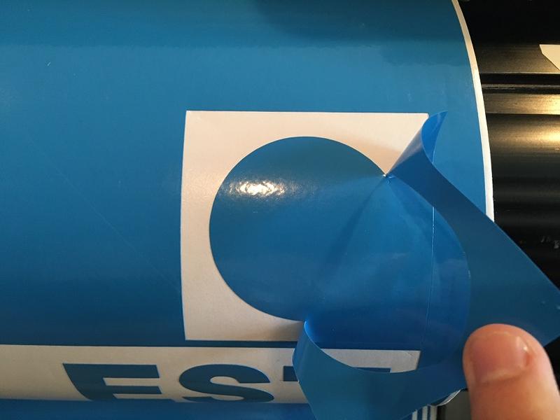

An Archive Thread saved my cutter: http://www.signs101.com/forums/archive/index.php/t-6483.html

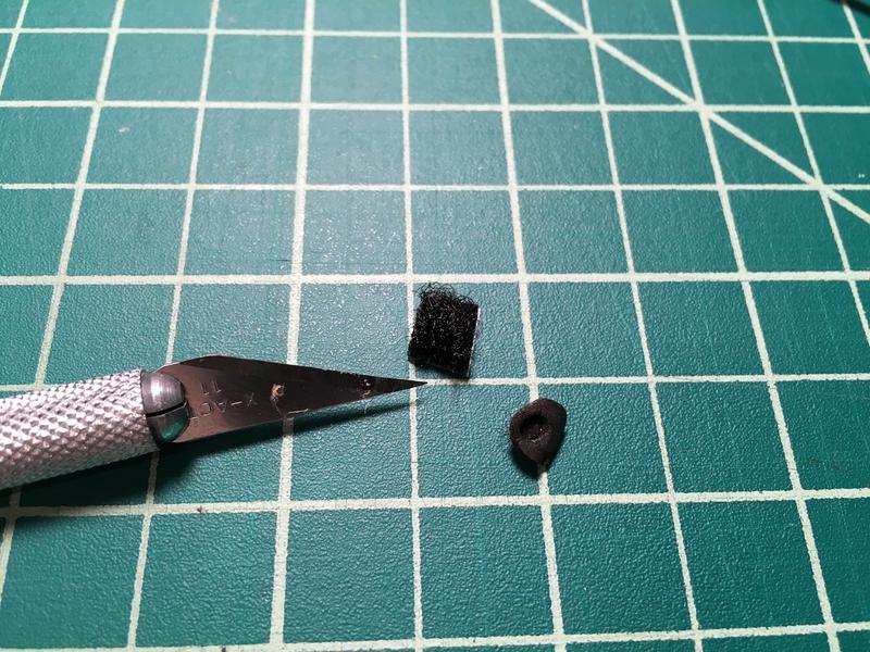

If your Summa is not completing the cut on the first shape, please check this tiny foam bump stop for the solenoid: I replaced mine and it worked terrific. It was hanging up on the screw, preventing the light downward initial movement. Hopefully this will help someone else!

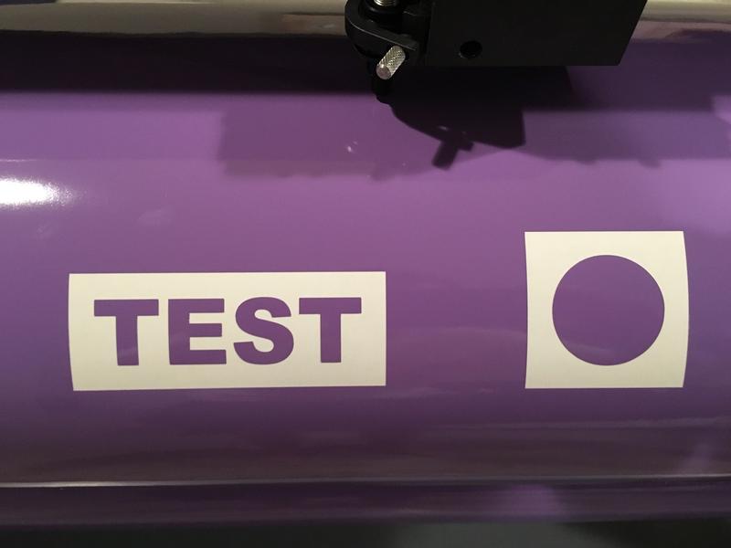

After replacing Foam with soft side of Velcro:

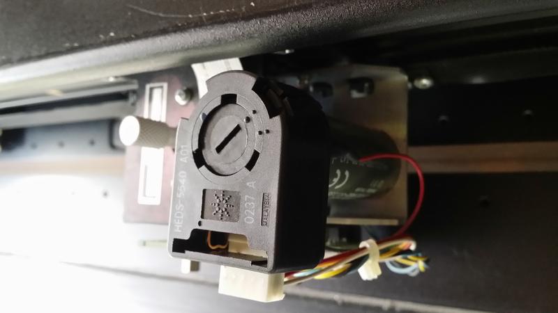

I'll add to that. Different series cutters have the different heads. My T series head is completely different. But, that initial thread link helped with the dental rubber bands, but I was still getting some skips in the beginning. So, upon further investigation on the head, I took a second look at this:
attachment.php
The portion on top of the solenoid. Initially, mine was turned to the two braille dot. Wondering "I wonder what this does?" mode, I turned that cap to the single braille dot and instantly pre-loaded the solenoid a little more. That seemed to solve the issue instantly. We'll see - I'll have a text laden cut job set up for next week.
FrankW
This is the Servo Motor turning the knife in cutting direction. What you've manipulated is the encoder of this motor. Not shure what could happen now, but I would switch back before plotting larger jobs.
This part have NOTHING to do with knife up and downs, so nothing to do too with missing cut lines. And before continuing playing around with that head, be aware of that this parts are extremely expensive. In earlier times, when just this little motor can be bought separately, this little motor alone costs more than $400. Today, replacing the head on a summasign is a economical total loss.
Lifting the knife up and down is the job is job of the electric magnet on the left side of the head. But as soon as this problems appear, there are no easy solution for that.
