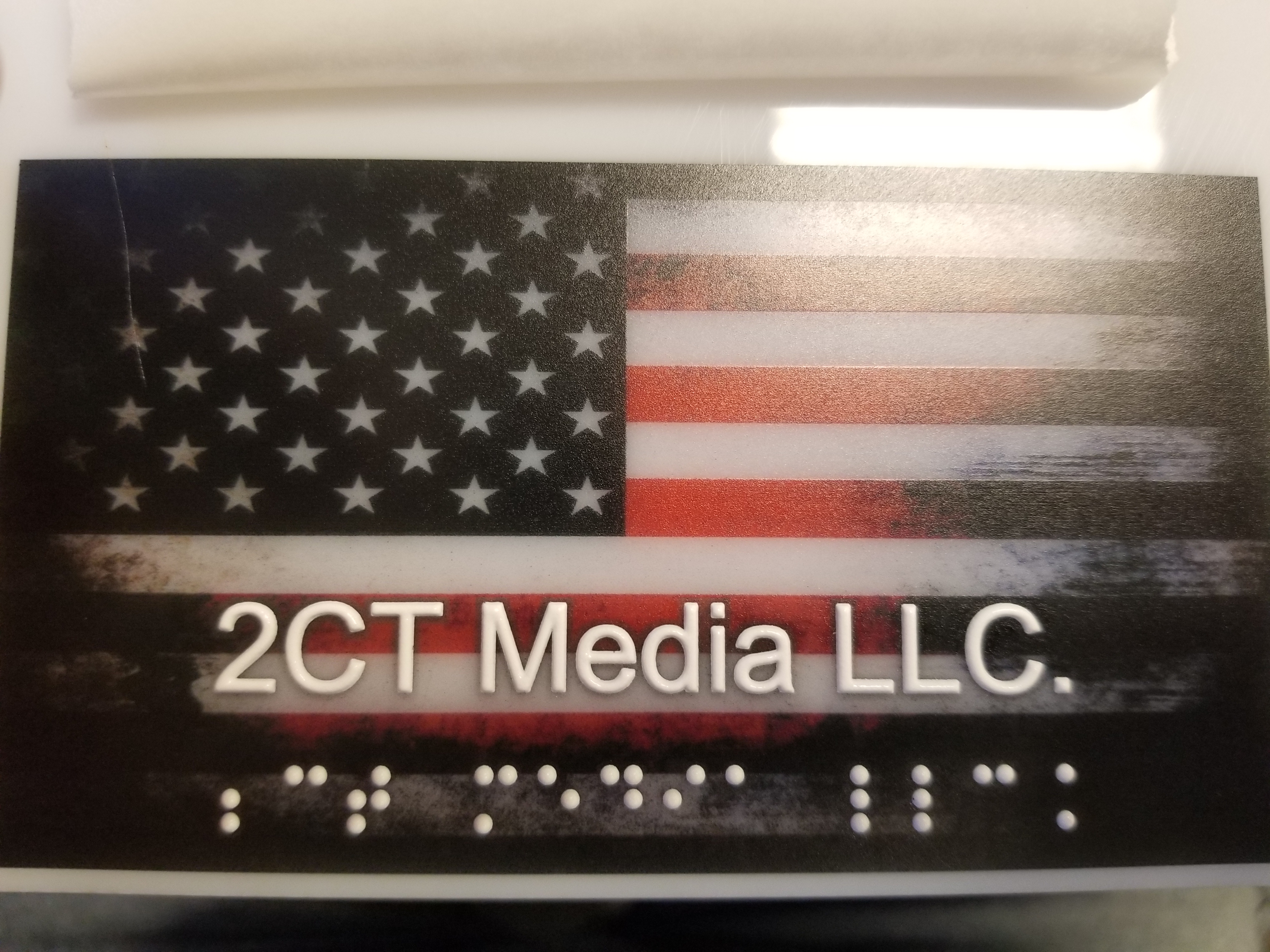

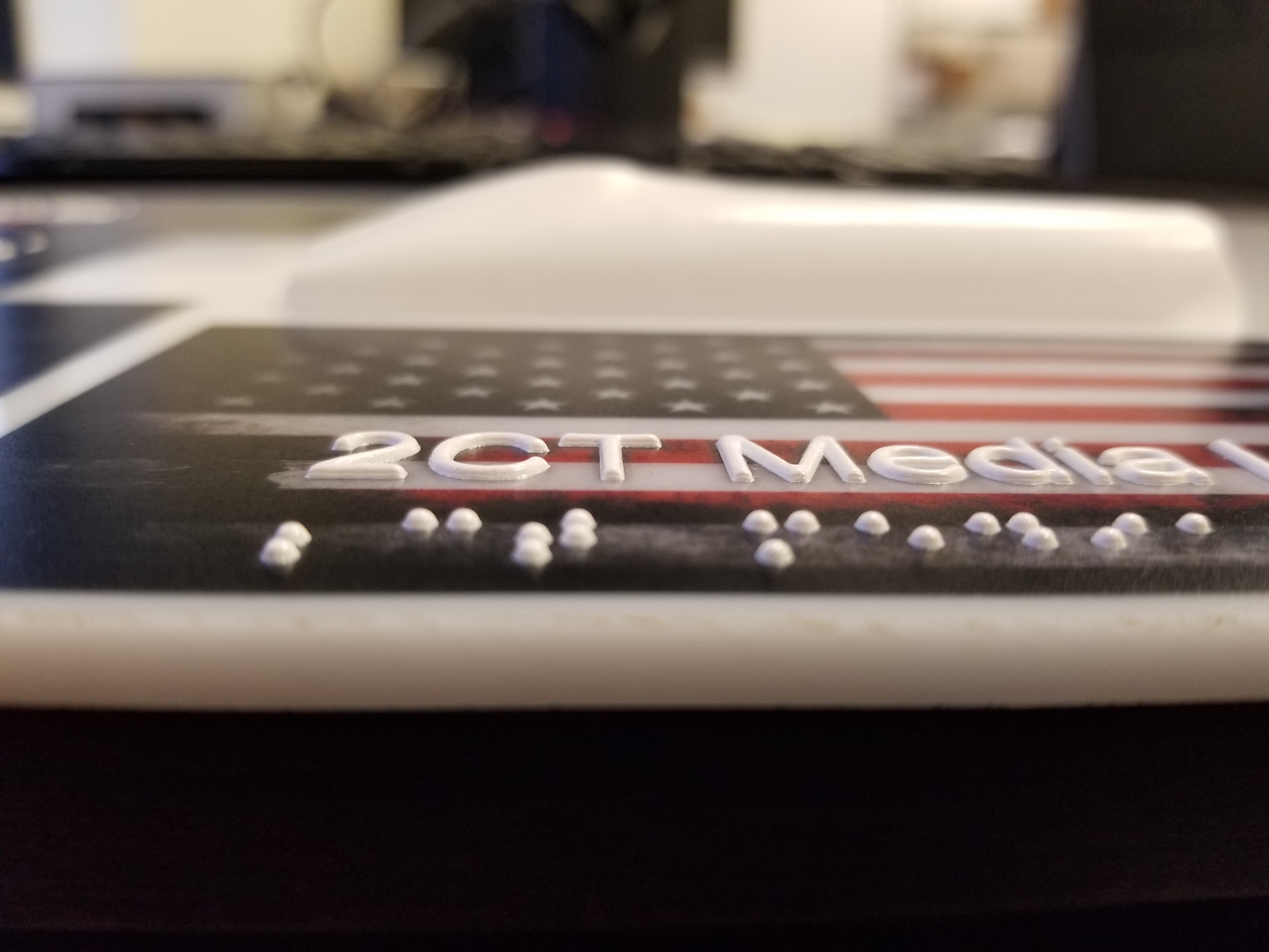

Vanguard all the way... we were not impressed with Oce at all when we were shopping. We have the vanguard you are looking at and it is hands-down a better option. Their service is phenomenal and the machine is a beast!
Quality to speed is far superior to Oce', plus you don't have to pay extra for layered printing like tactile or braille.

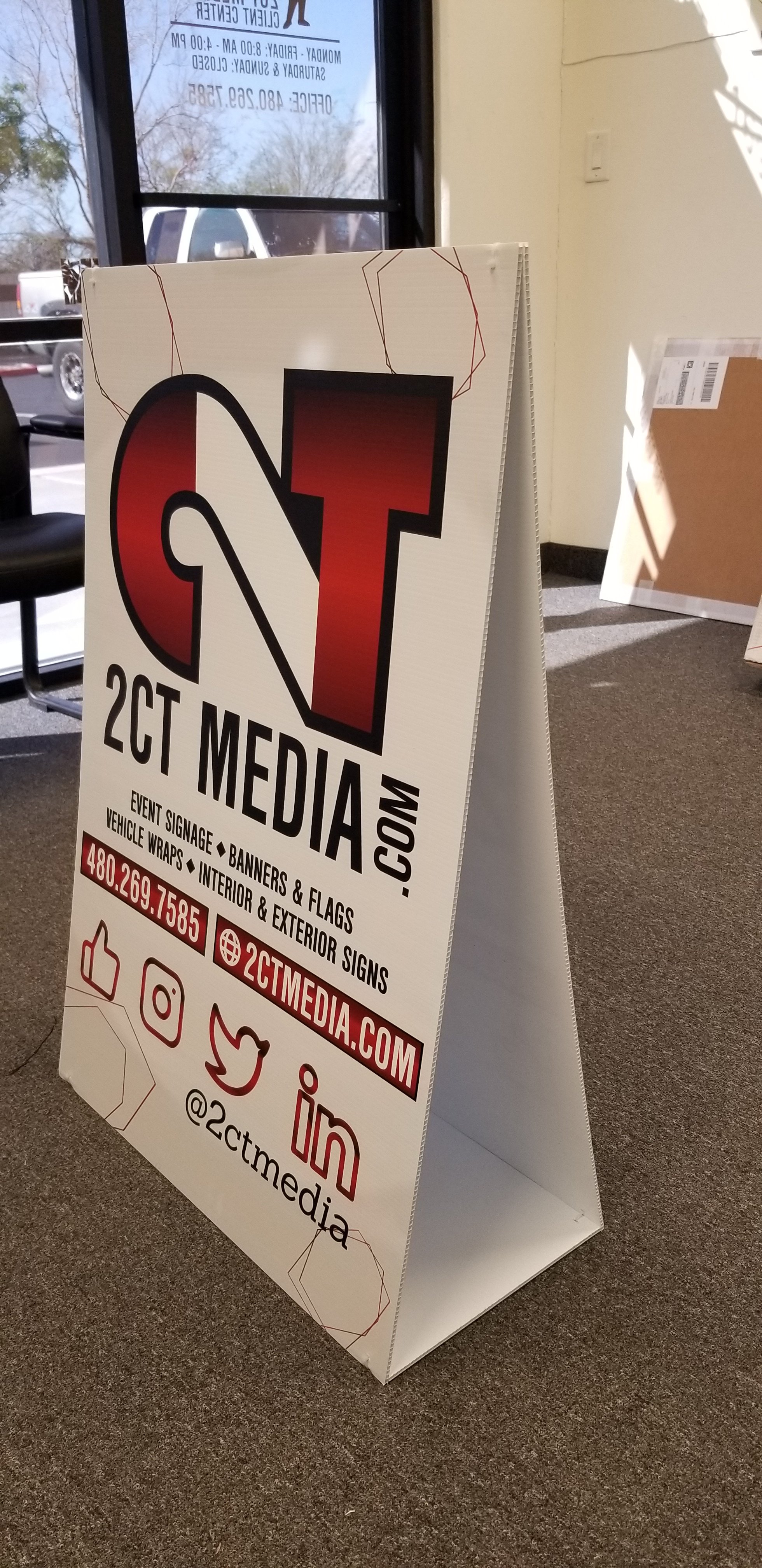

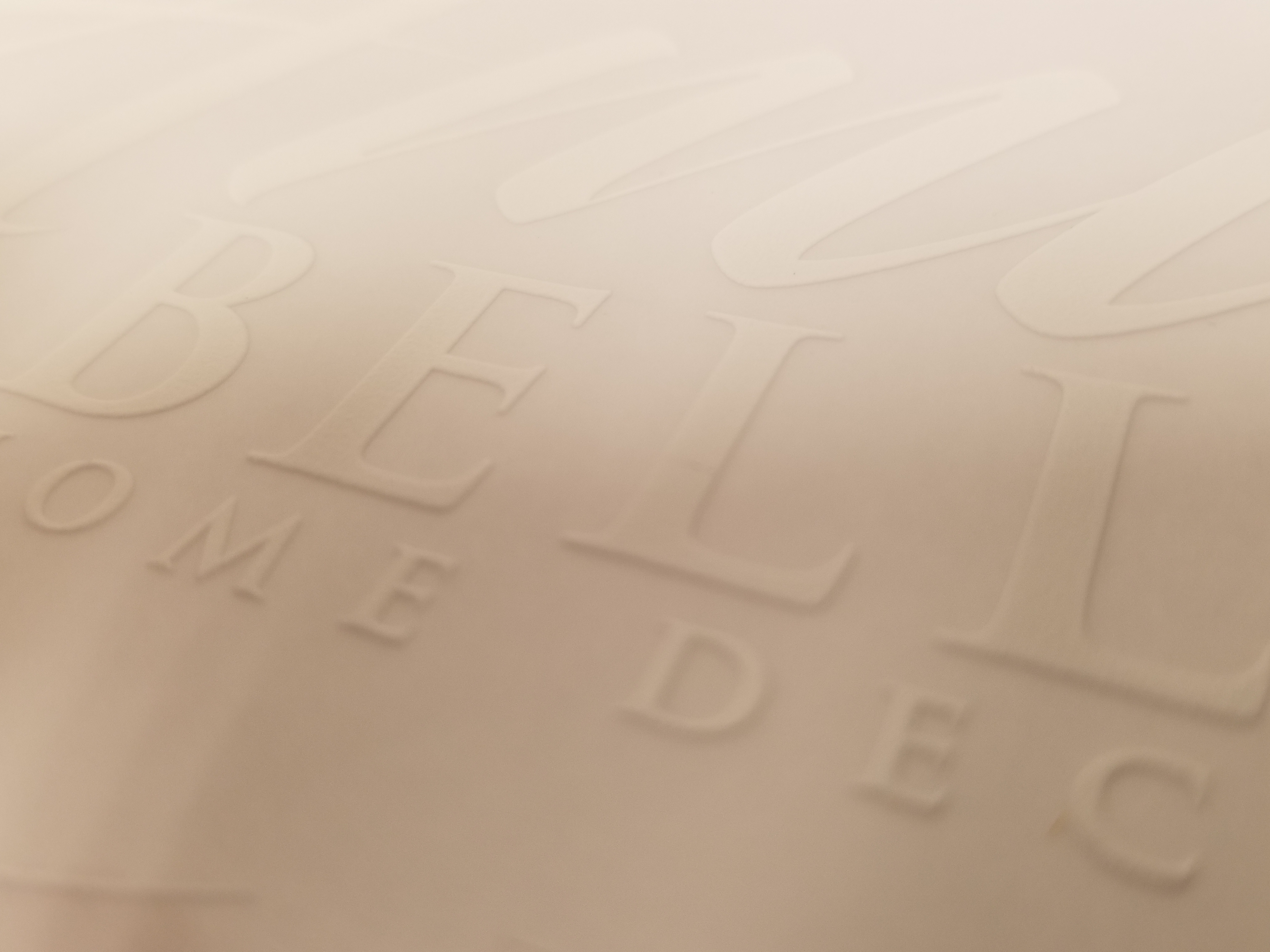

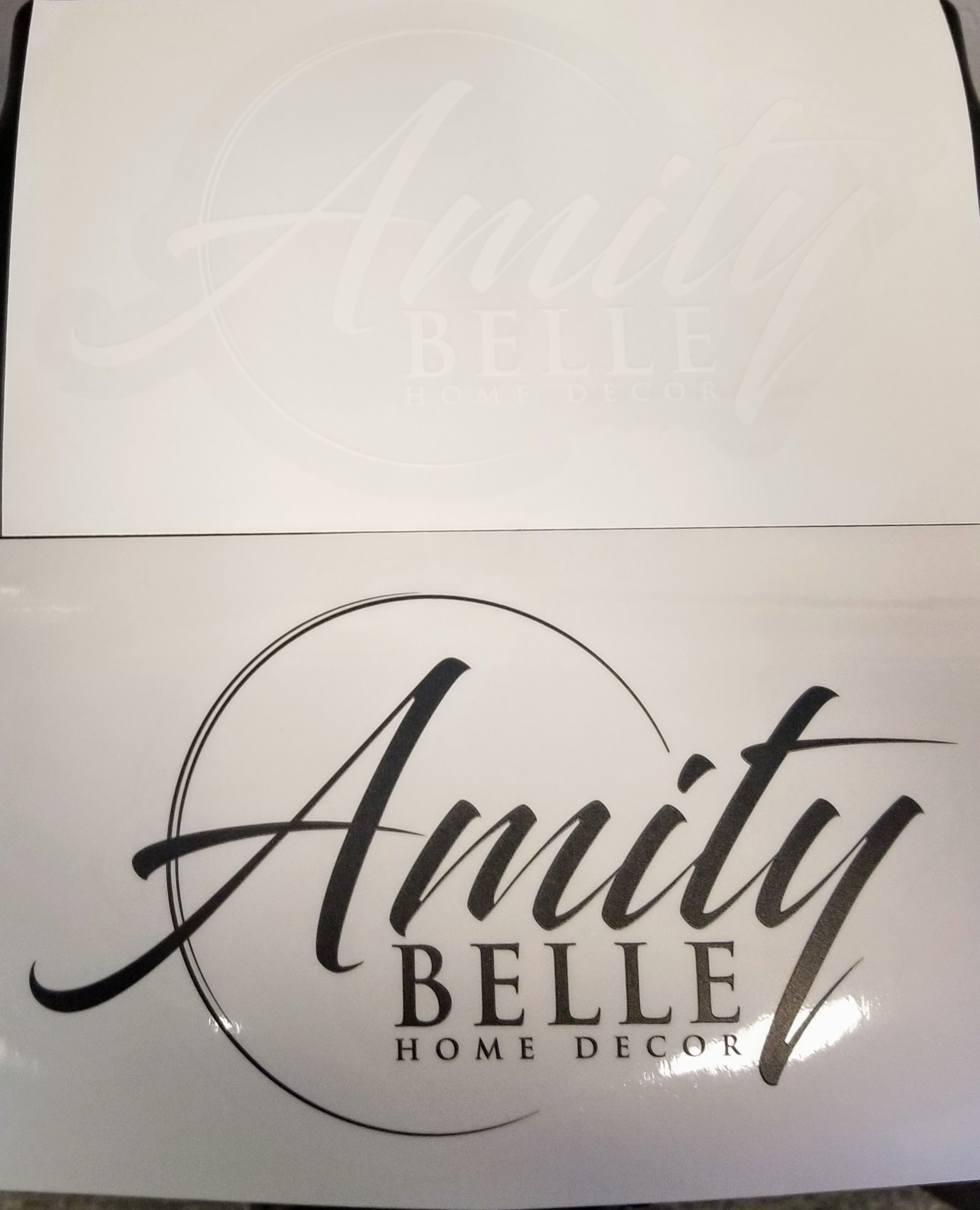

I will try to answer this 1 by 1.
Did you purchase your unit new? Yes we did in December 2019
If so, would you purchase it again knowing everything about it up to now? Yes, we are contemplating getting their roll machine. So Yes!
If so, is there any options that you would have changed on it? There are a few things they are working on, but not really at this point.
How many heads and/or rows do you have on your printer?
We have 6 heads currently CMWYK KYWMC config.
How many 4x8 or 5x10 sheets can you print per hour? In our preferred 600x1200 CMYK 4-Pass about 2.5 mins a board on average.
How is the white printing? Any issues with printing on clear acrylic in reverse and then having the white flood as the top layer? We want to make sure the printer we purchase is going to have a good white option for art prints and printing on clear vinyl. White is awesome but takes a lot of maintenance. 4-Layers of White is very opaque and fast. No issues on acrylic or vinyl. See images.
I've been reading good things on them. I've heard good reviews on here... We were looking at the LX3 Pro but it was sold and I'm thinking the VK300 series would be ideal if purchased new and there is also a used unit on the market now, but I think it has 6 heads.
The Company, Team, and Machines are awesome. We love being a part of the Vanguard family. As for Used vs New, I would reach out to Dave Cich about that. He is totally honest and knowledgable.
How much is it to add more heads or is it rows? To help speed up the printer...
Heads are about $15,000 + Install, do know if this is special pricing or not so don't hold me to it.
How are the ink cost per ink box and square footage in terms of usage? Ink is the wildcard and comes down to profile building.
I assume when printing on vinyl or banners you can only print the size of the flatbed as in 5x10, is that correct?
You are correct.
Would you mind to share with me the price you paid for you printer? If so, my email is mark@ballparksigns.com. I've read they are under 200k and can print up to 50-60 boards per hour.
They are under $200K and you would need 8 heads to hit the 50+ range. I will send you an email more about my purchase.
