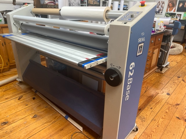

We have a beautiful Seal 62 Base with heat assist top roll for sale. $5995. These are $16k+ new Picked up only se Pa 19540.
