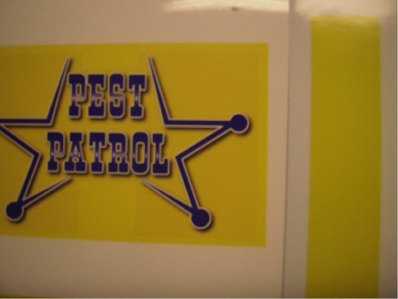

I think the pic worked. I am pretty sure it's a flattening issue. The yellow box to the right is from adobe using the roland color swatches. Prints just fine by itself, as always. If you look close at the logo, there are parts of it in the right color, but there are boxes around the drop shadows that are greenish. We have often fixed this and know that in ai you must flatten to print the feather or drop shadow effect. When that does not work, we usually open in ps in order to save as a large jpg. The flattening issues typically are no longer an issue and we have minor but noticeable color changes. In most cases this is ok. But now on this job any file type we try to save in ps shows the boxes around objects. The file is rgb and we have tried cmyk. It was originally created in ps and we have tried to separate the layers and recreate it in ai, but either we flatten or it gets flattened during a save giving us slightly different but similar results. Sometimes the whole background is greenish and sometimes it's boxed around the flattened images. I am trying a few more things right now, like creating a transluscent png in ps and importing it to ai. Then on another layer create the yellow box behind it. Save as a pdf. We have tried over 20 things and nothing works, but on another job with a red background and a feathered effect in ai, I deleted the feather and it was just fine... but no feather. On this job we cannot remove the drop shadow. I will also try turning everything to cmyk, but that has in the past made the blues less brilliant. We will change the blues in this case. We are also trying everything else we can think of and any suggestions that come up that we have not tried. Thanks for your time and help, DD

in the photo you can see the correct yellow outside the 'bounding box' of the drop shadow.
transparency issue.
do you have rendering intents set to the same for raster and vector elements?

The exact same file prints absolutely fine on a nearby machine using FLEXI. The same Roland sp540v machine, the same photoshop tiff cmyk file, but not ran through versaworks... this leads me to believe versaworks has a problem keeping the colors and art unaltered. We also cannot get a nice yellow from ps at all. In ai the roland color palette prints fine if the file contains only vector, but all colors change and clipping boxes appear around raster images, or drop shadows/feather effects. I find this issue discussed here on signs101 and others on a google search, but no SOLUTIONS. This wrap we are doing is luckily being printed off-site, but in the future I need a solution for ripping/printing without color changing, etc. I there a ripping service available that works with versaworks? Any suggestions or solutions are greatly appreciated. DD
