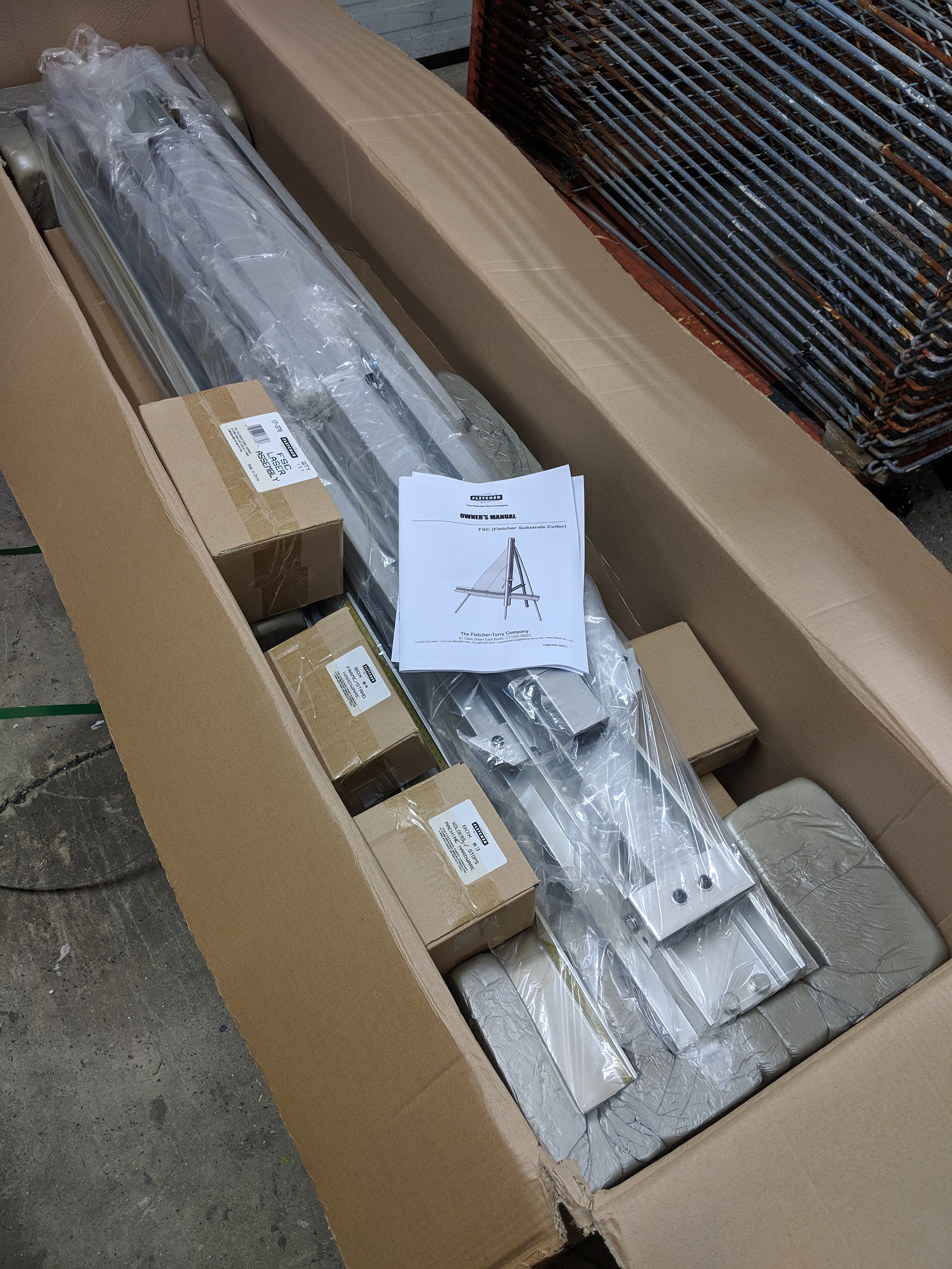

So this year, cutting so many covid related pvc signs by hand. I swore that i was going to buy a Fletcher cutting system!
I looked into it a little bit but did not find many places selling these things in Canada.
Grimco Canada had it listed but was not in stock and ordering it from them would mean they would order it from the US and ship it up here. That made the unit more expensive than it should be and decided to hold off on the purchase.
Last Tuesday i got an advertising email from one of my other suppliers saying they had them in stock.
Well, i called late afternoon on Tuesday. Wednesday morning got a call from accounting and they had an invoice for me. I paid it. Received the system today! Woohoo!
I plan on a wall mount installation.
Is there anything i should look out for. Anything to avoid. Anything to make sure of?
I haven't read the installation manual yet so i am just asking in general.

We got ours from Grimco about 10 years ago at a show Grimco was holding over the weekend in Connecticut. The Fletcher rep was there and explained just about everything to me about the unit. He said it will stay and cut more accurately if you use the tripod, instead of a wall mount. Also, we can cut 6mm ACM. Never tried the glass or metal. Have other equipment for that. I think you've seen ours in action and it only takes up a little less than 3' out from the wall, fully set up. We also have a laser at the top to help in case it goes outta square, which has really only happened once from a clumsy person who fell into it. Wonder who that could've been ??
Only thing to be careful about is, don't overtighten the hold-down bar. Although it doesn't look like it's tight up against, it is.

Hi Gino. I appreciate the info about overtightening the hold-down bar (will look out for this).
I remember now you talking about the wall vs. tripod installation.
Thing is the specs say it has a depth of 43" on the tripod and 17" for wall mount.
My shop is less than a quarter of the size yours is :confused:. I have to try it wall mounted.
I have the perfect spot for it but if taking up 43", it would be awkward. (Doable, but it would take up important walking space)
I'll have a look at the hardware and if needed, get bigger lag bolts to secure the thing i will.
I've got plenty of levels i can use to make sure the thing is square.
