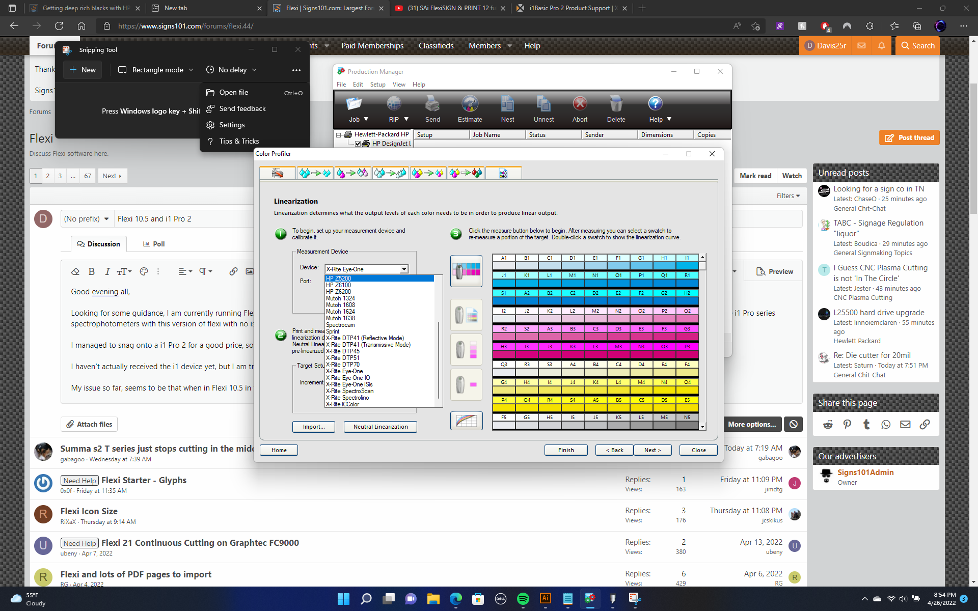

My issue so far, seems to be that when in Flexi 10.5 in the Color Profiler, the i1 Pro2 is not an option under devices. See the attached screenshot for a list of x-rite devices available.
Are people using the original "x-rite eye one" option? I did read one post on here about the i1 Pro's using emulation on the older flexi systems, or will the i1pro2 become available when connected via USB to my laptop? Or am I able to add the device information into flexi via program manager.

Flexi 10 is too old to support i1 Pro 2 native, but the Pro 2 is downwards compatible with the first generation i1, so you can configure the i1-Option available to use your device.
Vassago
Or you can always generate a profile externally.
I do it on all media, different Whites are not the same
