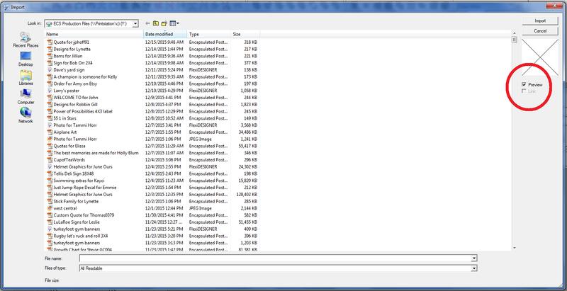

This is all I got for ya, sorry if it does not help.

When you save a file in flexi it creates a temp file for the thumbnail preview. That way it only has to open the temp thumbnail file to give you a preview instead of actually opening the whole file. If you uninstall and reinstall the program it will erase these temp files. This also happens if you just delete the flexi temporary files. Or if you copy files from one computer to another sometimes the preview doesn't come with it. Also, if you export a file instead of saving it, flexi doesn't create a preview thumbnail for it.
The kinda fix is: If you open and re save a file you should be able to preview it again but you will most likely have to do this for all your files if you want to preview them.
