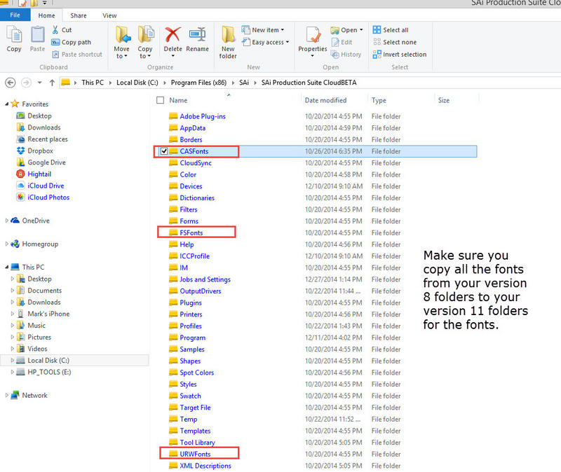

Match Fonts fro V8 to V11
Make sure you copy all the font directories from V8 to V11. See attached image. Both versions also reference the fonts in the windows font directory, so make sure those match also.
