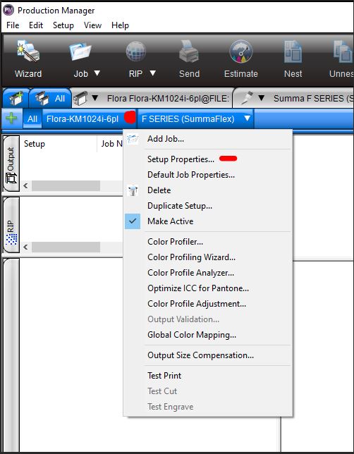

By default Production Manager would send them in order that they were done ripping. Say you send 3 files, file 1 was sent first, file 2 sent second, and file 3 sent third. If file 2 finished ripping first it would print first, followed by whatever finished ripping second.

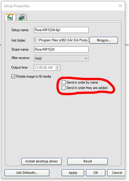

SAi has just added a way to control this in version 19. If you click on the white arrow to the right of the printer's name in Production Manager and select Setup Properties you will get the below window. On this window you can now send files ordered by Name or when they were added to Production Manager.
View attachment 147647 View attachment 147646
Yes I think that did the trick, it wasn't working at first, then I saw another person saying that you have to restart the program every time you make a change, which is really annoying. I really appreciate everyone's help
Well I thought it was working, but I've noticed that it's still randomly printing jobs. I think it's got to do with the HP properties option that allow continuous printing by rearranging jobs. If I uncheck that option then it won't print the jobs, it just rips them then doesn't print them.

Seems that it's still an issue even with "send orders by name"
Even if I rip one by one they still randomly printed
