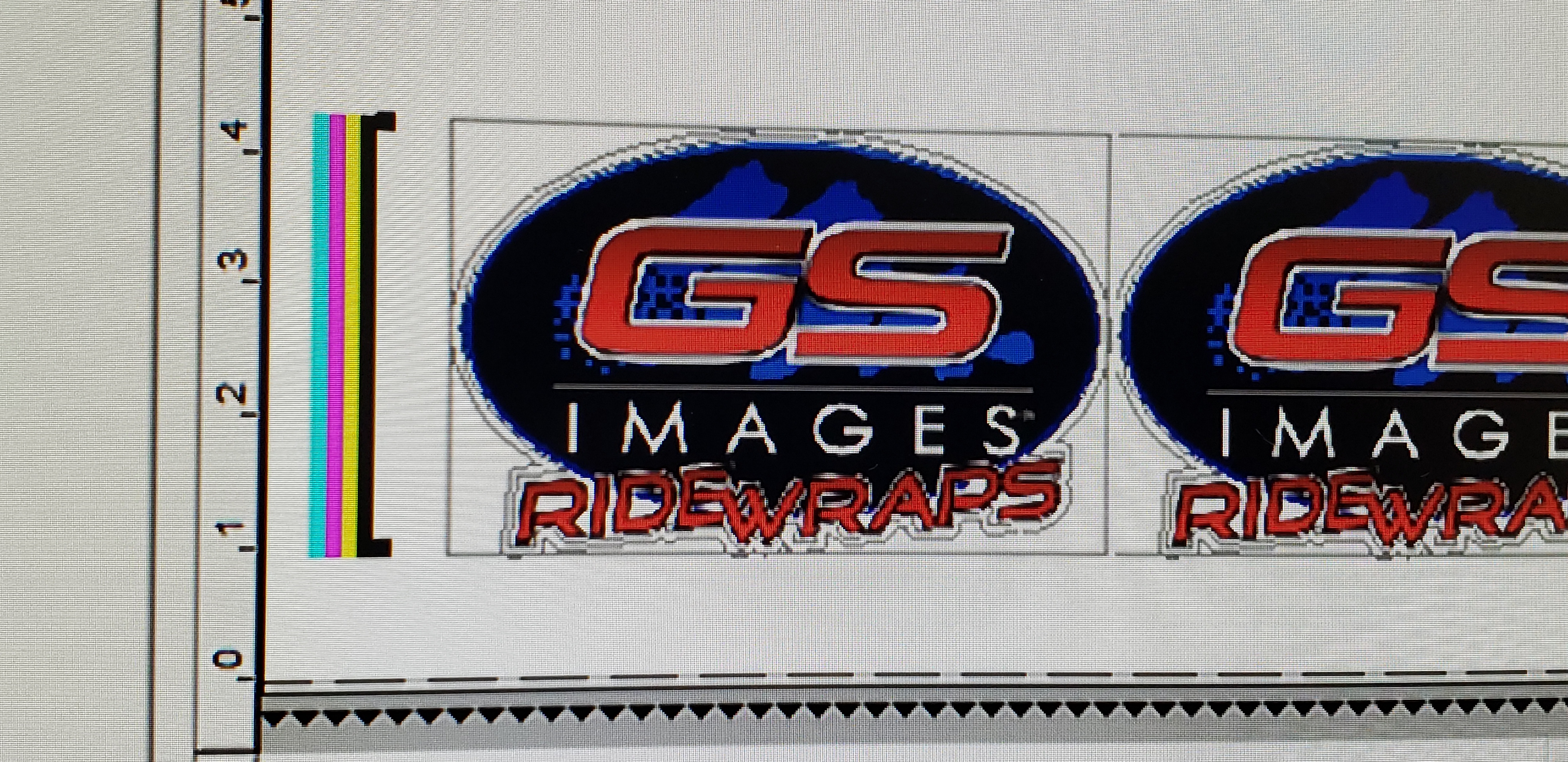

Anybody out there running this combo? I generally like to run a color bar on the left side of our prints, one....it helps diagnose print quality issues...and B... it also aids in cutting after laminating (It keeps me from mistaking loading the cutter backwards) :)
I can't seem to find a setting on the Epson to run this by default, and if I have it added in Flexi, it prints the bars directly next to Summa OPOS marks, hindering the reading of the marks with no space between.

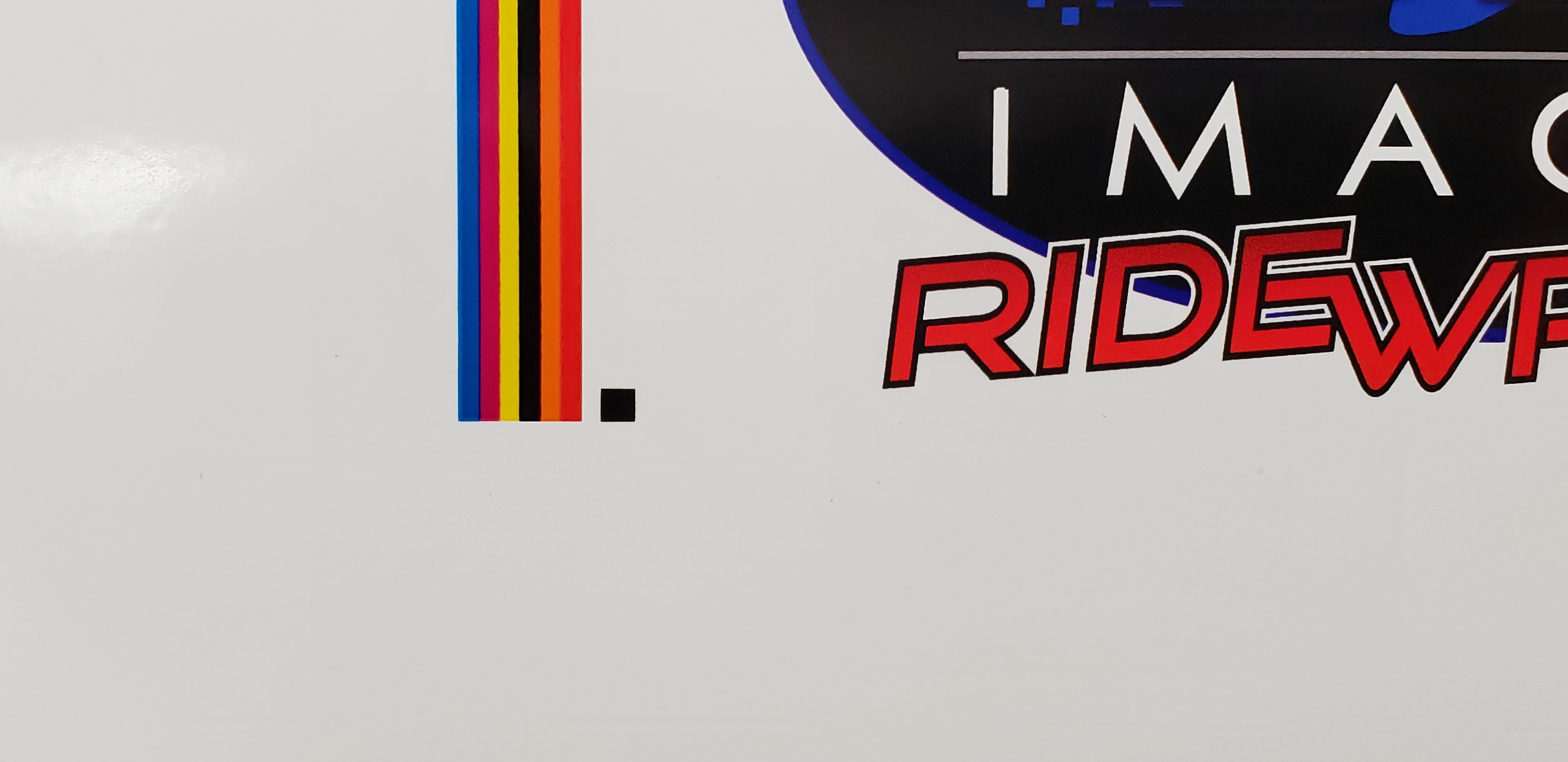

Well, surprisingly...I went ahead and sent a few logos to test and the S160T read the marks with no issue.
Pic on the left is the Flexi preview, and that had me worried it wasn't going to work. But I was wrong.
At least now I know.
I couldn't find anywhere were I could add a margin in Flexi that would work. Profile isn't for white Ink so a .5" margin with a background color wouldn't work. But all is good now.
