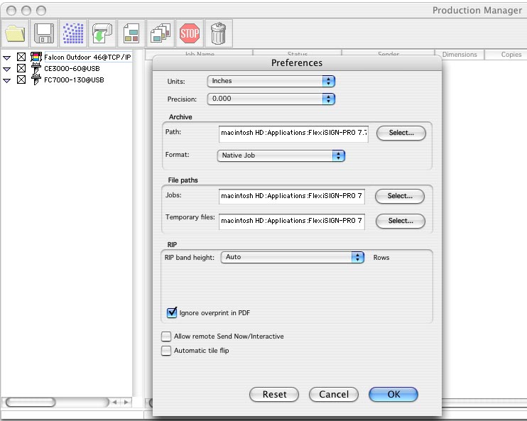

Derf
No there is no option in the preferances like there is on the PC!
It's got to be in there some ware.. I bought a used copy so Scanvec wants to charge me for the tech support.. Maybe I'll try to play stupid and call again.
Damn the software works so much better on the MAC too and I can't see them leaving this option out!

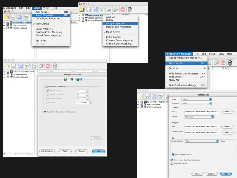

Derf
Have a look!
I'll email them! I forgot about their e support

I'm sure you tried this but:
Make sure "send now" is selected not "hold in list" in P. Managers cut/plot window.
Sorry that was not very clear . When you send from flexi you get the preview screen RIP - Print dialog box etc. Top left there is the box that has your printer and then properties
