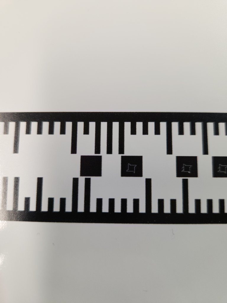

I don't know if I am missing something or what is going on, but I can't seem to get good results cutting from Flexi at all. It doesn't matter if it's print and cut or just straight cutting vinyl, the corners when cutting from flexi are always messed up and the cutting looks messy in general. If I am just cutting vinyl I have resorted to just using Winplot instead because I can't seem to get flexi to cut properly. When cutting from Winplot the cuts are perfect.

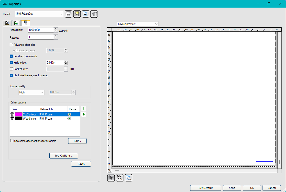

So as you can see in the one picture that was print and cut, for some reason the boxes look as if they have horns. So like every one else I'm thinking the offset is wrong. It's not, and that is what the other picture is showing that the offset is set correctly. I've tried checking the box and setting the offset in production manager, I've tried having it unchecked and it being set on the cutter, doesn't matter, it does the same thing every time if cutting from Flexi.

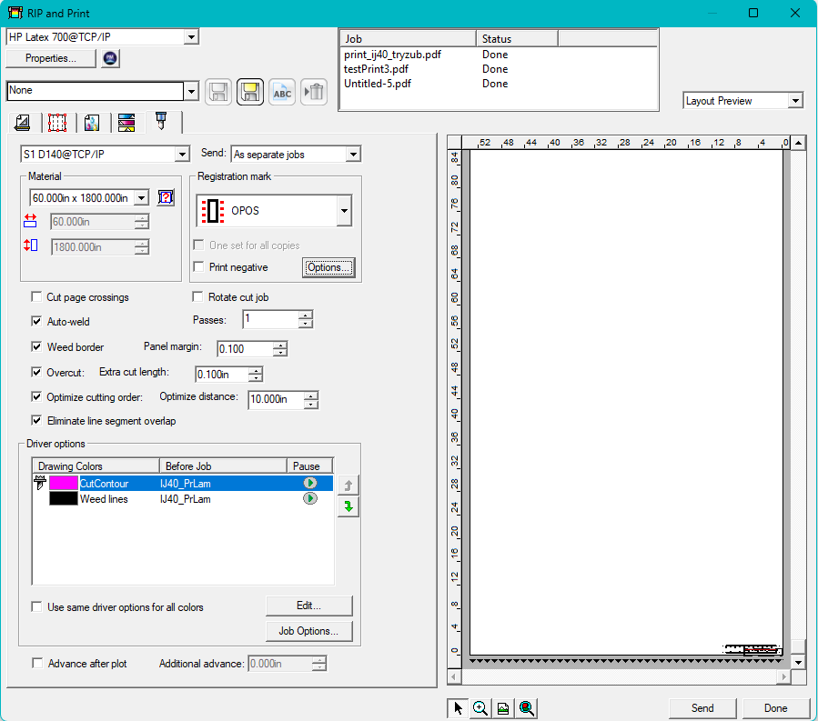

I have also attached my settings from RIP and Print and Production Manager. What am I missing to make this cut properly?

Make it simple, disable everything in flexi that could alter the blade movement. Disable overcut, offset etc.
Then make sure your offset is set correctly in the cutter. Now any software you use will have the same output and it wont change unless you change it in the cutter.
Check that you are not missing any settings here. Also edit your default job settings to keep the settings.

I always set the offset on the cutter and not in the software. I think my screen shot I had it enabled just because I was trying all of these different settings. That is set in Production Manager, I will try disabling overcut and the other settings from the RIP and Print menus and see if that gets me anywhere.

That looks very much like an improper offset setting to me. If you have it set to the proper number for your blade, you might be allowing too much or too little of the blade to poke out of the holder or the blade might be broken as well.

Start by turning off OverCut. Your settings in the RIP & Printing have OverCut on and set to .1"
Ya for some reason I didn't even think twice about this. Usually everything I am cutting is larger and didn't become an issue really until I print/cut some smaller letters.

That's exactly what I was thinking and I think I spent too much time trying to troubleshoot the offset and was stuck on that. I tried increasing and decreasing the offset on the cutter way higher and lower to see what changes it made and see if it would come close to fixing it but it didn't. The blade amount sticking out is correct as I did check that and I did replace the blade just for fun to see if anything changed.

In the end I did end up disabling all of the settings from Flexi as balstestrat mentioned. Double checked the settings on the plotter were where I wanted them and sent to cut again and it then cut perfectly. In the end I think it was like Aaron said, way to much overcut. I am going to turn that back on by itself and do a test just to confirm that was the issue. If it wasn't then I am just going to turn them on one by one just to find out exactly what the cause was.
