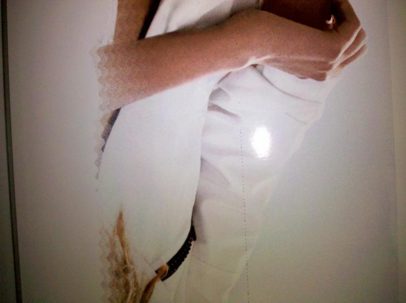

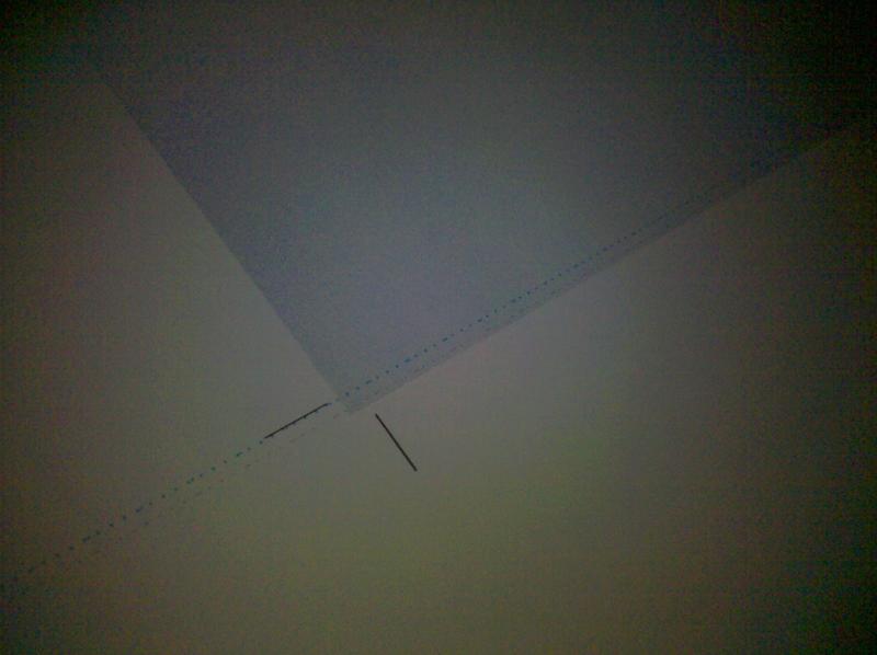

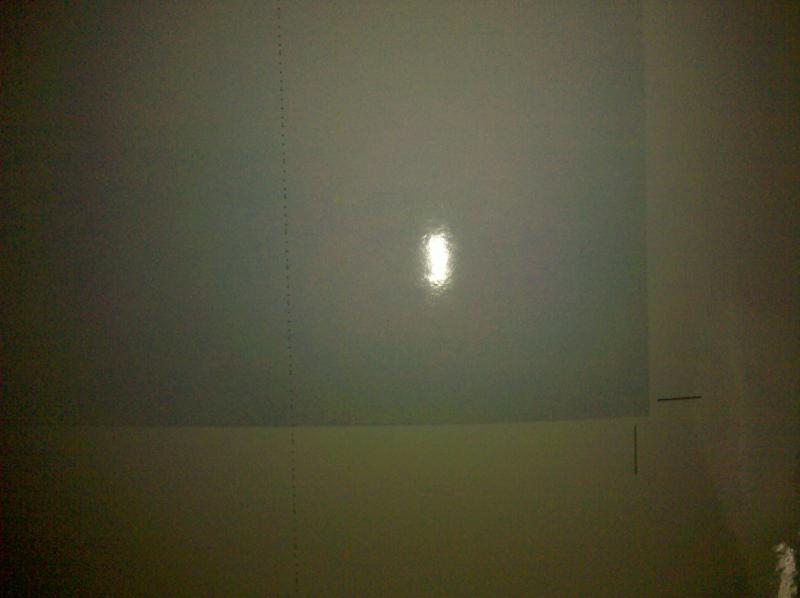

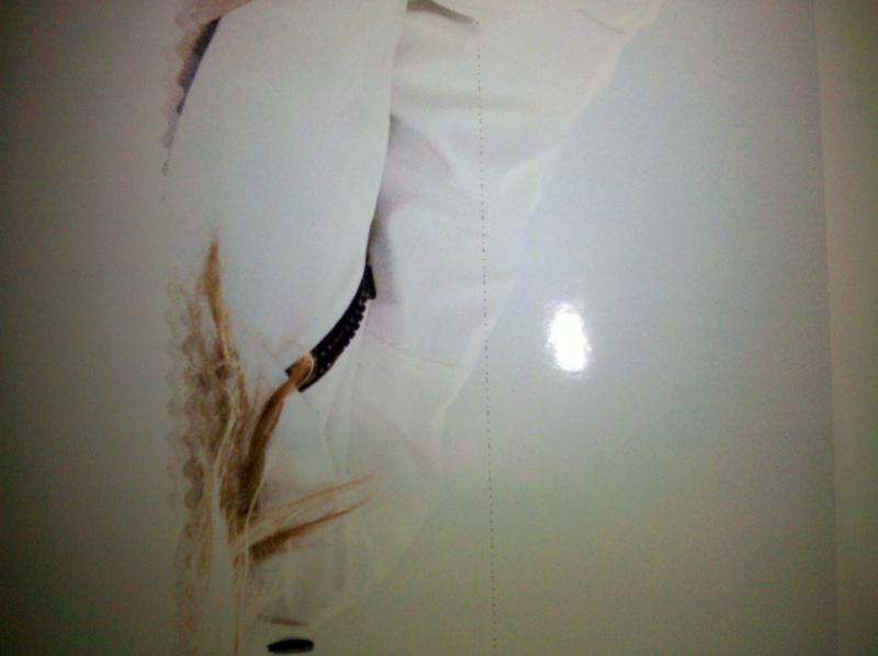

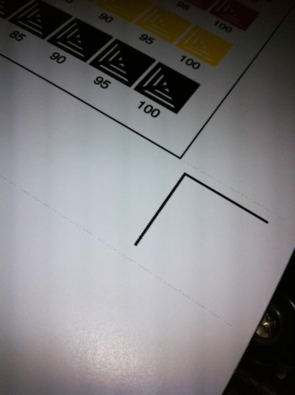

anyone else had this issue with printing in flexi cloud. see pic of thin black line

Its a Mutoh TOUCAN LT. It only does it when flexi is using some sort of marker or border. If it is a group of contour cut stickers, it places a line only where the sticker falls right below each sticker, cut that the only place. That and where the crop marks fall. I wasnt having this issue untill i started using flexi cloud.
