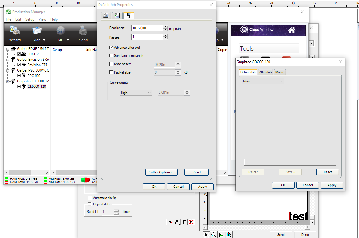

I used to run a graphtec on flexi - same problem. But I found using cutter settings, from the cutter menu was the most reliable. And turning off Cutter settings in production manager setup - image
