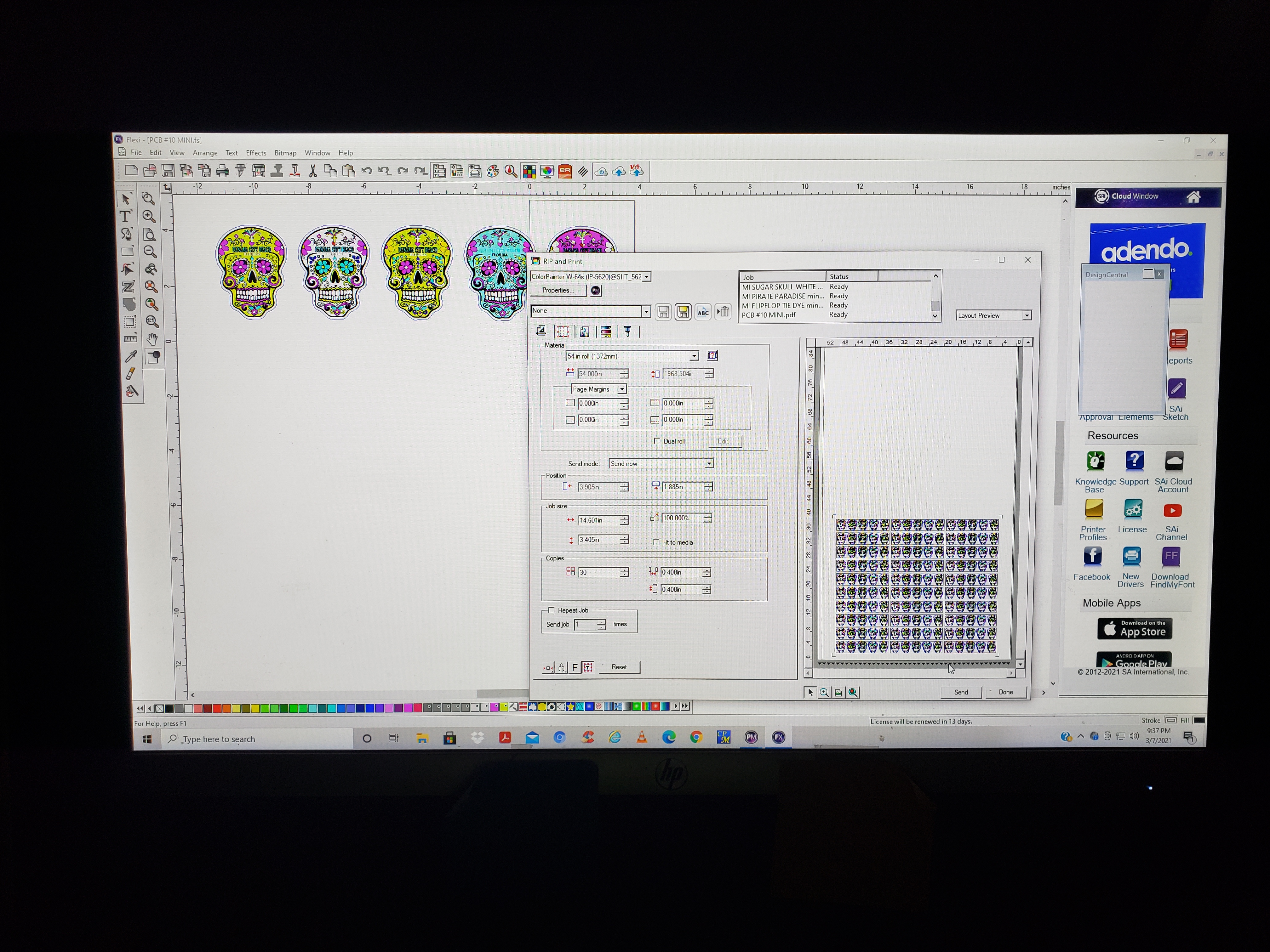

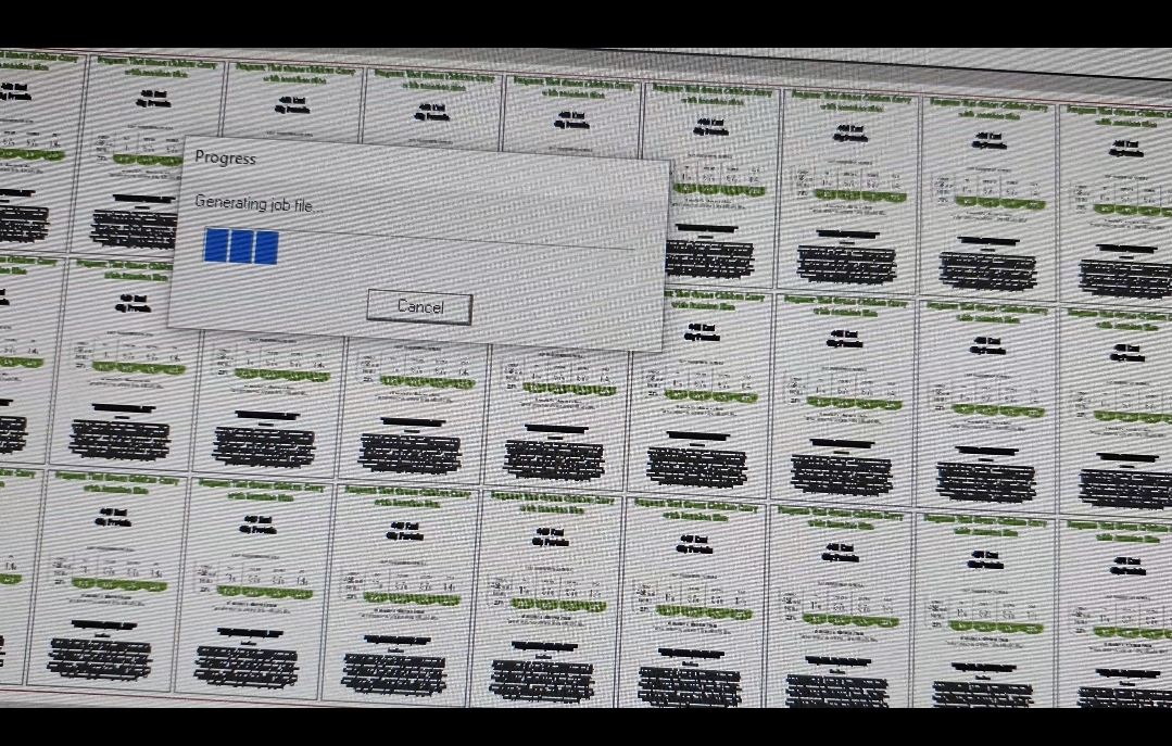

Im using SAI FLexi with my HP latex setup, it been running AOK for a few years but all of a sudden it slowed down, really slowed down.
My PC is a bit of a beast, but all of a sudden the time it takes to generate a job file is massively slow, like 10 minutes from clicking send to the machine starting to print. Does anyone else suffer from this or know what's causing it. Latest version of flexi 19 and the PC spec is: HP Z620 Workstation Win 10 Intel Xeon Quad E5 1620 v2 3.7, 64GB ram and 250GB Samsung SSD.
The screenshot is 50 labels being sent to the printer - it took over ten minutes to have the machine kick into life. Ive got the video on Youtube if anyone interested, but you can hear me calling the PC and software terrible names - it was 7pm on a Friday night
