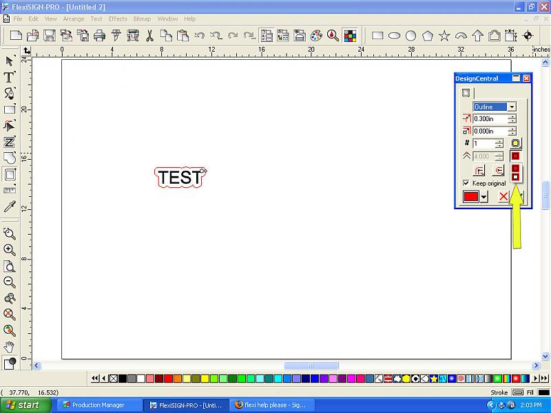

I want to use cut vinyl for this but i want the black outline to be solid and my flexi use to do it so i dont know if i changed something or what happened can someone help?

go to effects/ outline/look at designcentral, select withbacking button. must have selected without by accident. Hope this helps.
gvgraphics
Like GTSTech said in the design center under outlines there is a button to make the outline hollow or solid. Make the outline solid and that should fix your problem.
