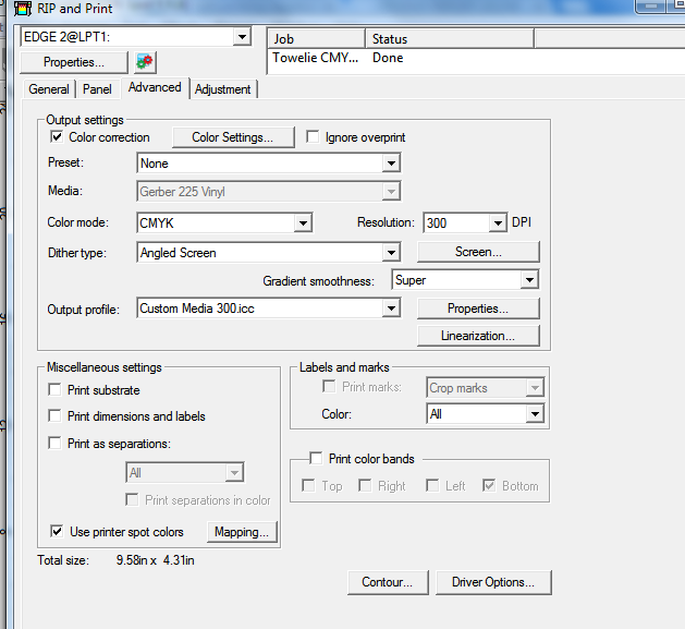

Step 1 Rip and Print:

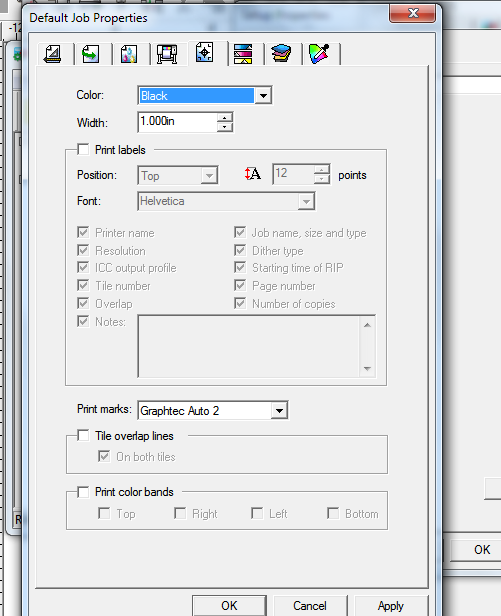

Step 2. Default Job Properties:
Jburns
. It said to go to Production Manager > Preferences but I don't see that in Production Manager or Rip & Print. I thought maybe they meant Properties in R&P but the next thing they said was go to Jobs and that doesn't exist.
That window is located:
Go to Production manager--- highlight your printer--click Setup--Setup Properties---Job Defaults---then you should see the options above.

I had the same problem with the same version of Flexi a few years ago. In this window, Rip & Print / Advanced / Driver Options / Color, be sure to always check BLACK, even if the file you are printing has no black in it. If this isn't checked I don't think it will print the registration marks. Of course, you don't have to put in black foil for the registration marks.
