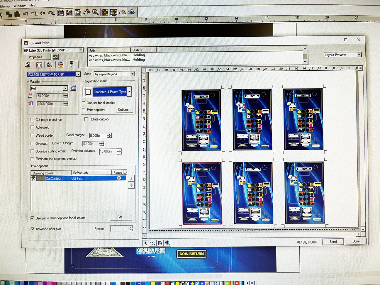

Attached is a screen shot of the cutting tab. When I send the job, the print file shows up fine, but it doesn't create a cut file.
I can send a test cut command from my computer to the cutter, so it's not a hardware problem, its solely a software issue that won't create a cut file.
Where in flexi can I do a load/reload last saved settings that you mentioned? I've look at every tab, setting, etc, and can't find a "reload" per sae.

This screen shot is from ur print mode
Now go to the production manager after print
And pick your cutter on the tab
Left below find the job name right click property 2nd from top and you should be able to see the cut line !!!!

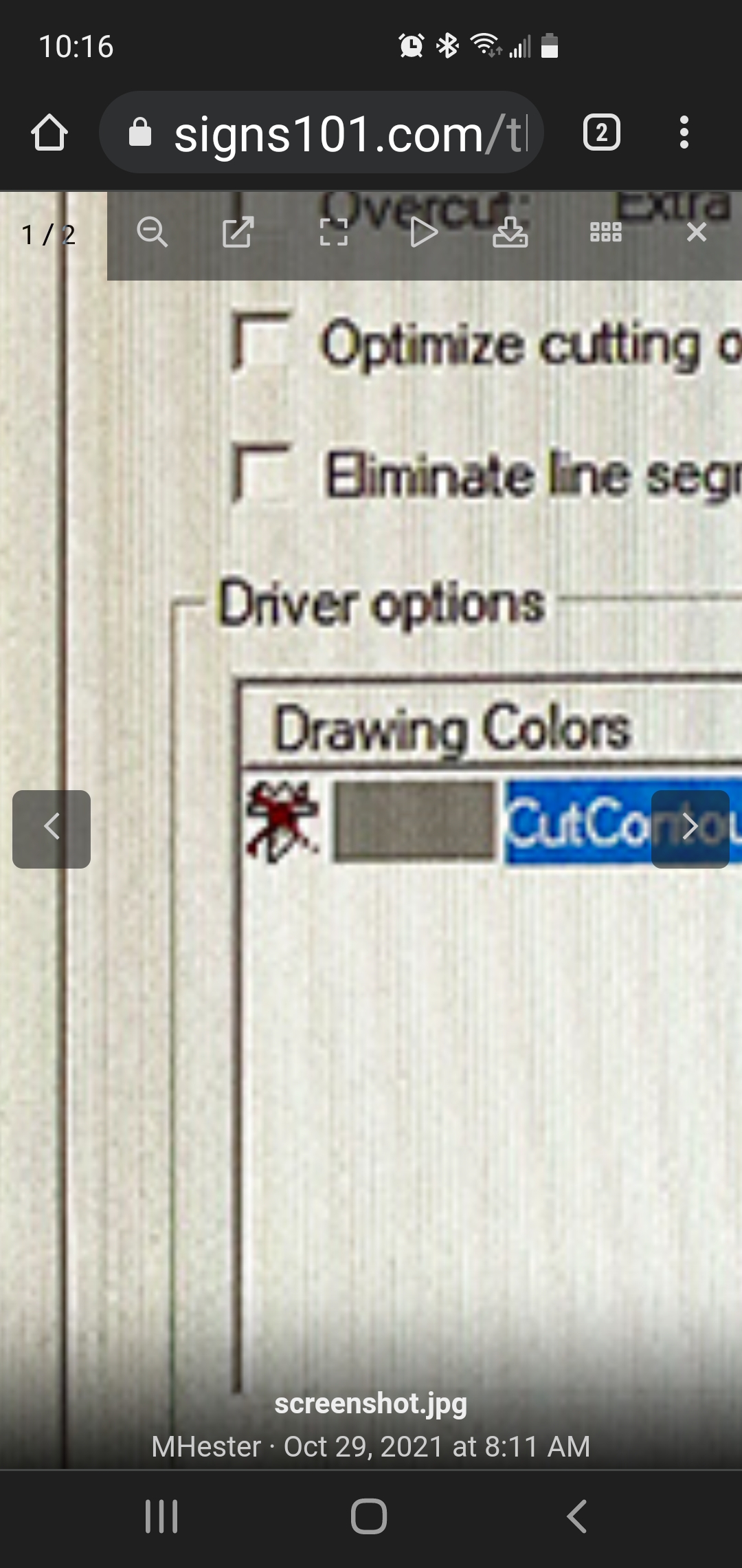

Joseph44708
I Drink And I Know Things
In your photo, bottom left,
Next to the Grey countour cut you have mistakenly shut the cut file off.
Click on the Red X to turn the cut back on.
