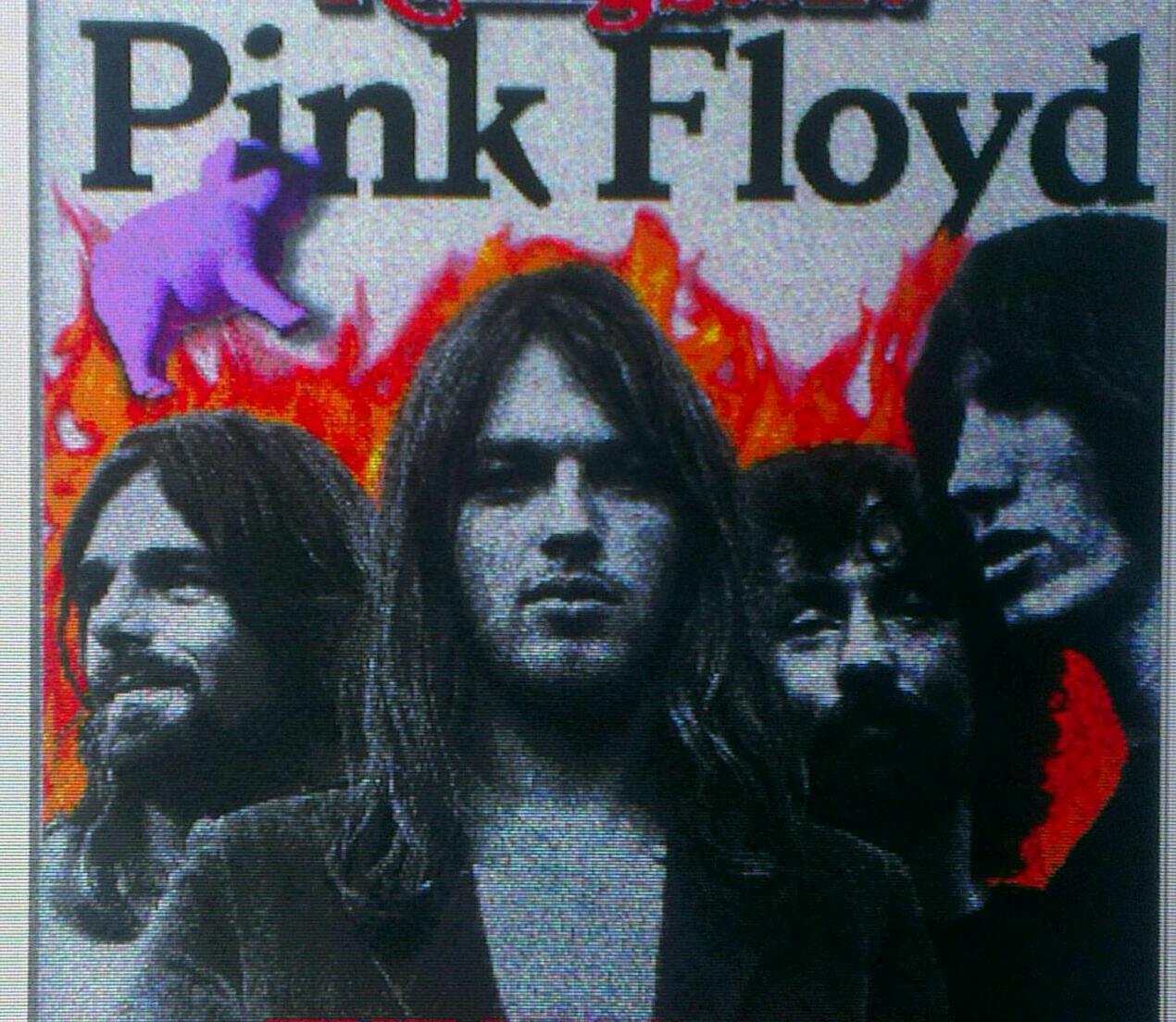

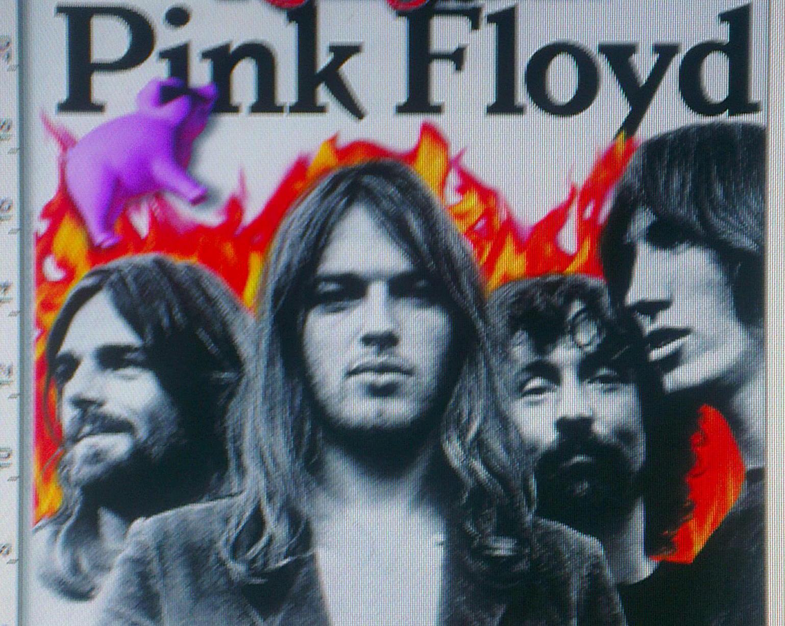

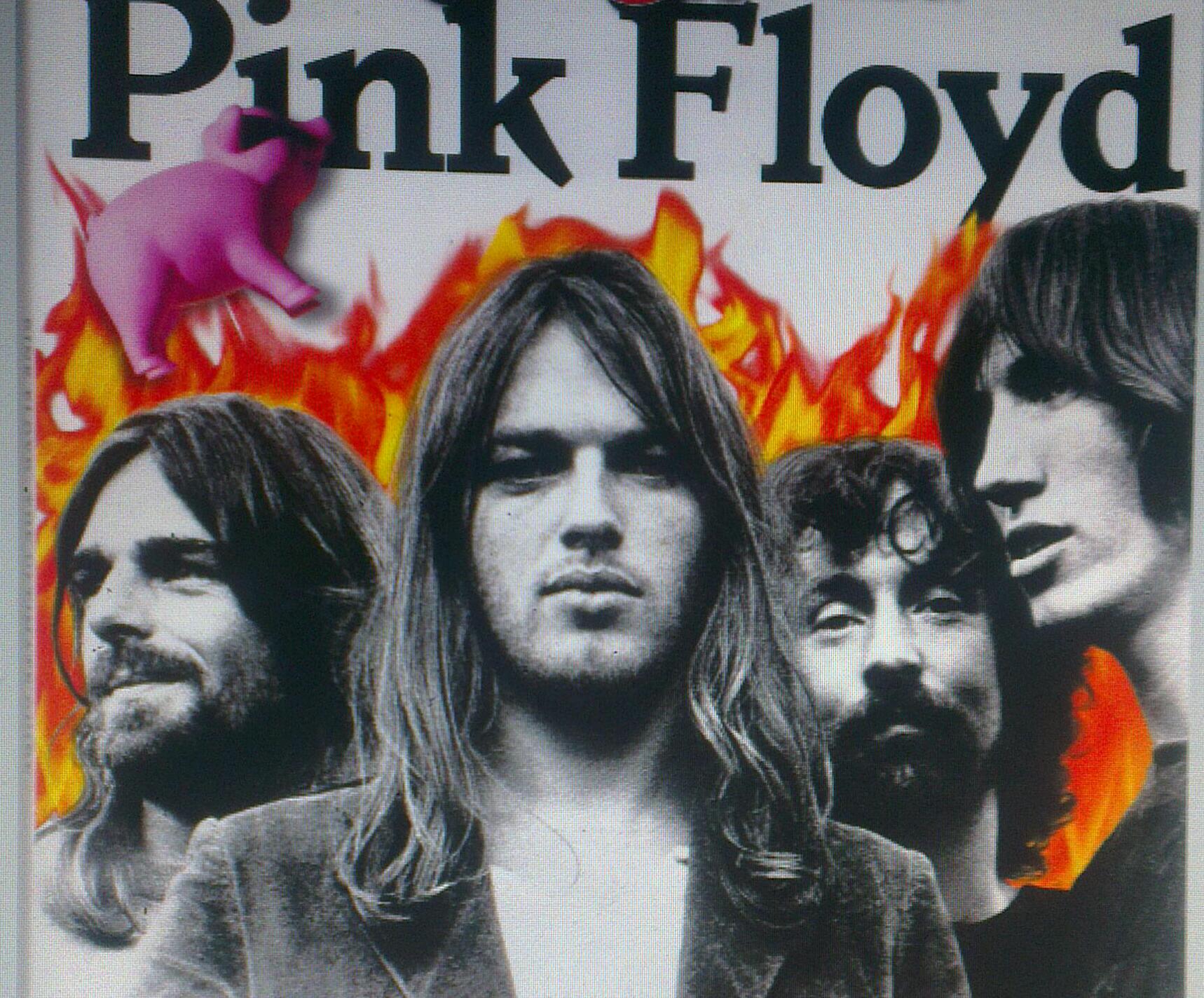

Hello
I NEED HELP
The image changes dramatically after RIP,
And even more so after sending it to the printer
Experience made with different formats PDF, Tiff.
As in RGB and CMYK
Is there a solution to this problem?
T hanks in advance

What printer you are using?
do you have color profiles assigned?
looks oversaturated because the profile that you are using is incorrect or you are not using any profile, is not a problem if you don't have profiles assigned but you need to adjust the CMYK ink limiters (last tab in flexi) manually
try all colors in 70%
