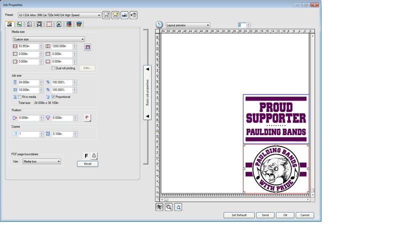

I've got a sign that I'm trying to run side by side on a 54" roll on my Mutoh. I can't seem to get it to do it. It only wants to run 1 column and 2 rows. I can use my imposition software to do it, but I thought there might be a way to do this in flexi directly. Any ideas? I've attachd the picture
Thanks!
Bryce

Have you tried selecting the top image and manually dragging it to where you want it to print? In Flexi cloud there is a button you can select specifically for Manual Nesting but I think in your version you can just grab it and move it.

Oops. I was actually running Flexi 10.5 and it has the option to Manually nest. Maybe they moved it in Cloud.

Hi Bryce - Try clicking the button with the little man. It will drop down a menu that has different orientations. Choose one that is sideways and you should be good to go!
