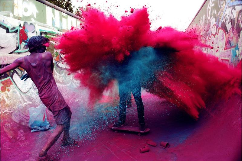

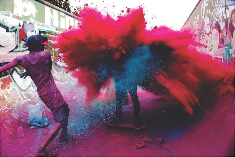

...but because of this one problem with Flexi has begun to stand out a bit more in our eyes. Whenever we click on Soft Proof in Flexi, it converts it to CMYK view, but the image and all the colors appear "washed out" or faded, like someone stuck a thin piece of digital vellum over it.
When Illustrator displays in CMYK the colors seem to appear a bit more "bright" or "clear", if those are the right words.

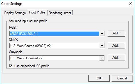

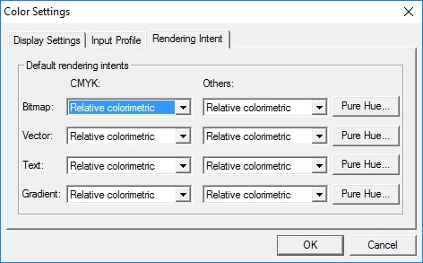

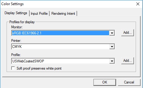

I've included copies of screenshot of Flexi with Soft Proof on and off and Illustrator displaying the same image in CMYK proof. I also have our color settings in Flexi in case that helps.
Does anyone know how to solve this issue or direct me to a post or article where I can soft this? I've tried scouring the Interwebs and the forum, but so far no luck...
Soft Proof on:
Soft Proof Off:
Illustrator CMYK:

Flexi "softproof" has baffled me from the start.... and has little to do with the output on our Mimaki(s). I've heard others refer to it as joke but this is likely because they were as baffled as I am. Under "Printer" in my color settings I have the two Mimaki printers listed and apparently the monitor should display the printer output depending on which printer I will be using. I would recommend using "perceptual" as the bitmap rendering intent, but all my other settings are the same (or been told to use). When it comes to bitmaps, I strictly use RGB and let the RIP do the CMYK conversions.

Well keep in mind that you're only actually soft proofing if you're viewing through the actual profile to which you're printing. So that would be the ICC profile in the actual media you're using. It's a little awkward to set up in Flexi, but it can be done.
Also note that your monitor is not actually sRGB, and it's guaranteed that whatever your printer profile is, it's not SWOP.
So with those settings, it'd really be better to just turn it off.
However, it is true that people have for years not liked the Flexi soft proof, and complained it's washed-out looking. And I think it's because they simulate paper color in their soft proof whereas by default Adobe does not.
If you take the image in your example, open it in Photoshop or Illustrator, select Proof Setup>Custom and then SWOP, and then select the simulate paper color button, what you'll see will probably match what you see in Flexi pretty closely.
(Also note, unless you've got Adobe 1998 selected as your working space in Illustrator and you're working in RGB and importing files into Flexi from Illustrator, that's not going to have any effect on this issue.)

With bitmaps the best and simplest results are achieved by sending RGB bitmaps to your RIP and let it sort them out. Converting them to CMYK before you send them is not helping the process and is, for the most part, futile. Vector and gradient objects can be another matter. Change your rendering intent for bitmaps to 'Perceptual'.

I have the input disdplay set to sRBG as that is what I am tod most web browsers use by default when they display on the web. So I can see what will be shown for proofs...somewhat anyway.
As for the U.S. Web Coated SWOP CMYK...I nabbed that from the Illustrator color settings since Illustrator seems to be printing and displaying so well.
I'll fiddle with the Illustrator proof setting and see how that displays.

I have set my Bitmap settings to Perceptual and we do test prints before big printings to match the colors to our Roland chart and Pantone books.
