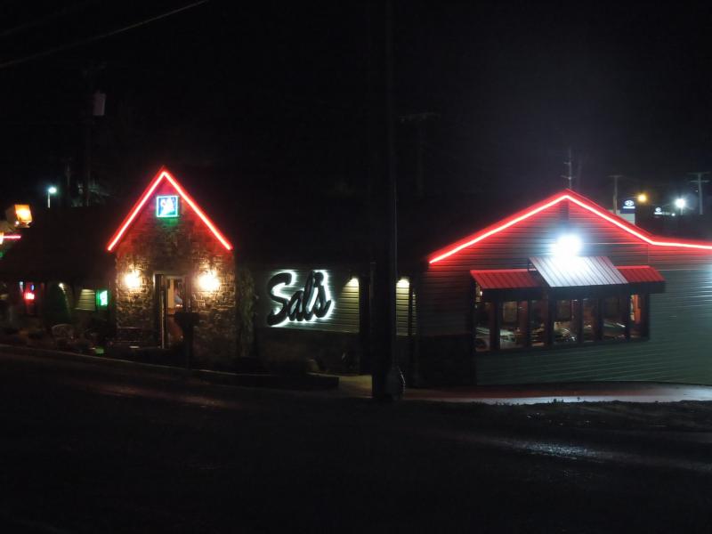

The Wadd
Boarder Flex from Osram
We just used this on a bar when the updated the Façade of the building. The only thing you have to pay close attention to is the way it links together and the plug end. They use small barbed pins to make the contact. Be careful not to break them and pay close mind that the pins hit the wisre in the ends. They can miss if your not careful.
