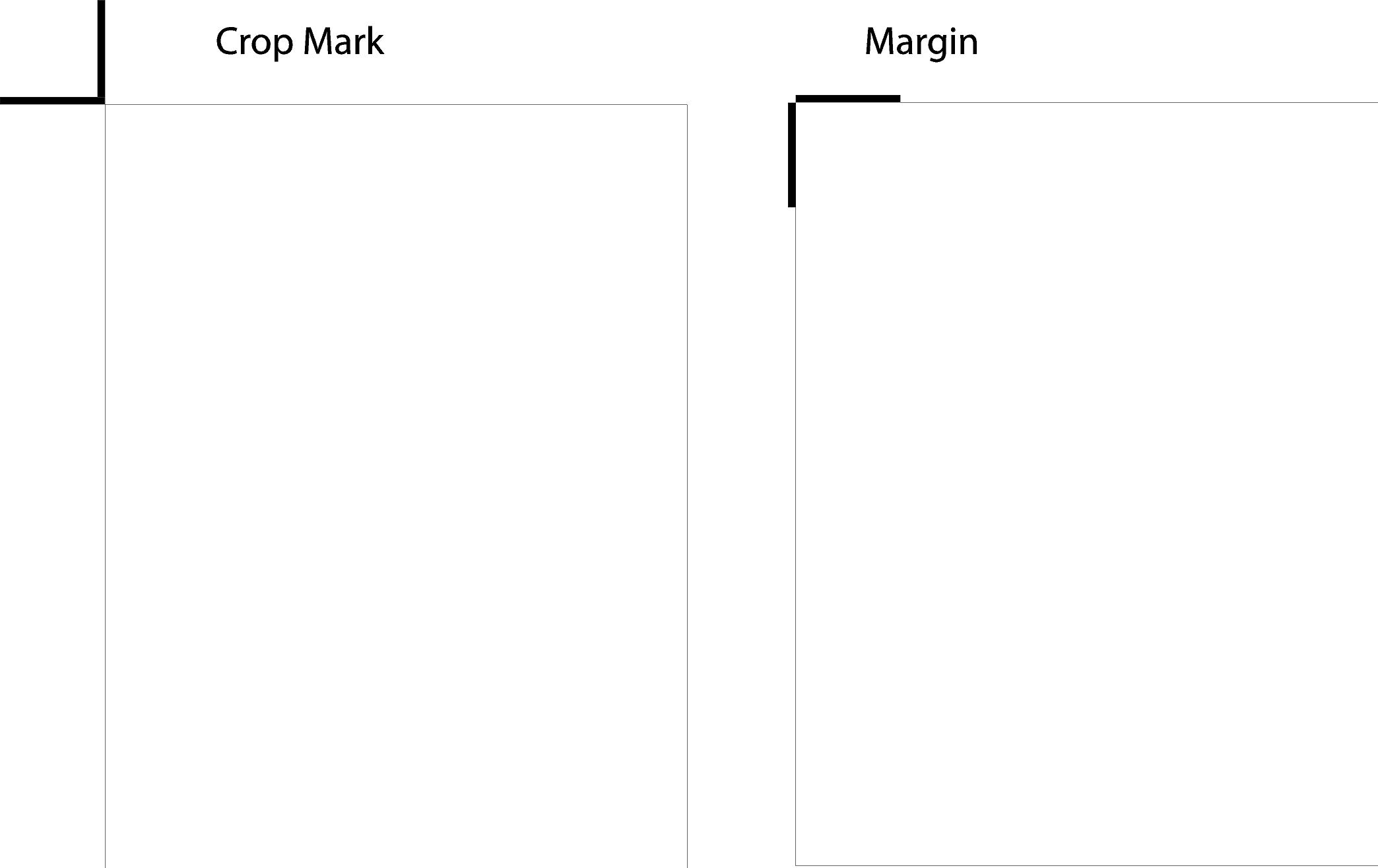

use MARGIN in Flexi RIP. Then you don't cut anything off when you cut one side.
