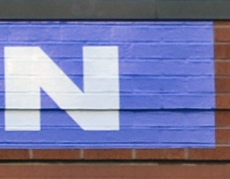

I have both types of aluminum foil, grip for floors and smooth for everything else. I'm quoting $16-$20/sqft.
Installations on brick, block and concrete have gone well and look great. I recommend trying it.
