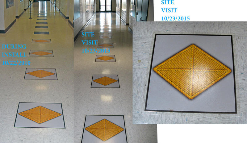

Made this earlier this year as an example to show a few prospects..... We printed these in 3M IJ162C and laminated with 3M 3645 floor graphics laminate. We were back on the site at the Army base exactly 5 years and 1 day after we originally installed these. They still look perfect! We did oversize the laminate by 3/4" to help assure they would stay down good and give a lower profile to the edges. This is a busy hallway in a school that gets the floor mopped at least weekly and machine cleaned monthly. Granted - it probably helps a lot that there are literally zero high heels and very little hard sole shoes (military dress shoes). Its almost always rubber soled combat boots and sneakers. Regardless - I was truly amazed that after 5 years the floor graphics still look like the day we installed them. If anyone doubts the benefits of extending the laminate a little on floor graphics that you want to last a long time this should help. Of course the environment and traffic on the floor also will make a big difference as well.
