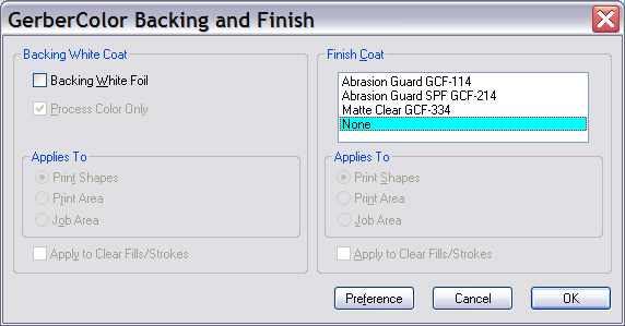

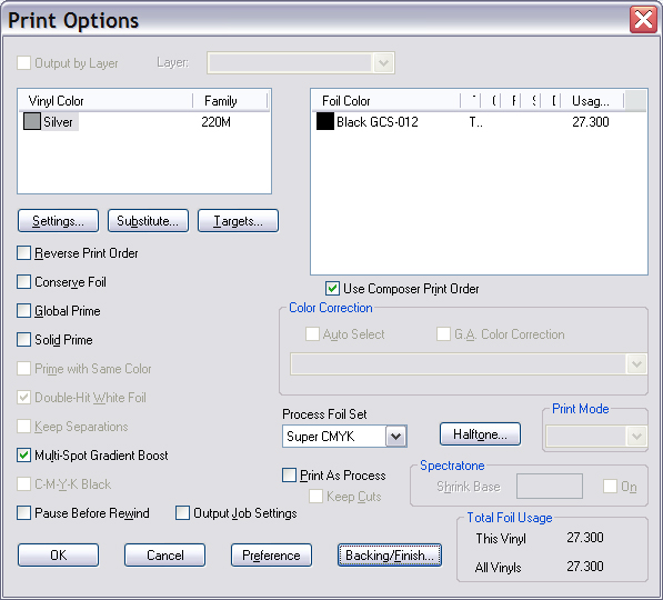

Do any of these foils appear in the GspPlot > 123 Print Options > Backing/Finish? That's where I usually apply them from.
the abrasion guard and matte do.....however the uvguard does not. i had it on my foil list untill i reinstalled omega, like i said i even did the updates from gerber just now.
i did try and apply the matte clear that way fred, but again,mismatch foil message. it also comes up with the message about do i want to use it as a process foil or something yes no cancel etc
