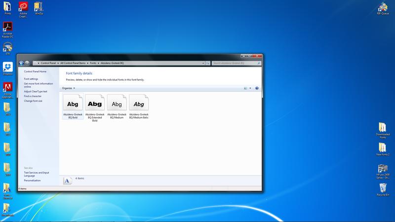

No, I've only ever installed the fonts myself. The problem seems to occur when I'm installing a family of fonts and some of the weights won't show up. If you look at the attached image, this is the font I am currently having issues with. I have 6 different fonts from family installed yet only 4 show.

try placing the fonts on your desktop then right click one and go to properties and check the details tab. I've seen some fonts listed as TT0005M_.TTF but the actual font is Swiss 721 Bold BT.
Artist369
So turns out my issue is the fonts that aren't showing up are named the same as other fonts i already have installed. Ok so the main family of fonts i am having an issue with is Gotham. Gotham Medium doesn't show because in the file it is actually named Gotham Regular, so because i already have a Gotham Regular the Medium is hidden.
