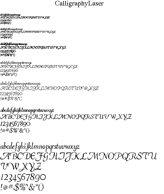

gurlwithapen
gurlwithapen
It is an open type font....not sure what the stipulations are in Robo Master? I can't seem to find any info on this on their support pages...

Three things come to mind ...
  • Robo Master Pro may not work with open type. You can download the same font HERE in TTF format to try in place of it. The font is simply named Calligraphy. The "Laser" in the name comes from the fact that it was originally published by Casady and Greene in a collection named Fluent Laser Fonts.
  • You may need to close and re-launch Robo Master Pro for the font to show up.
  • You may have reached a point where you have too many fonts installed and new additions may or may not show up in your font menu.
