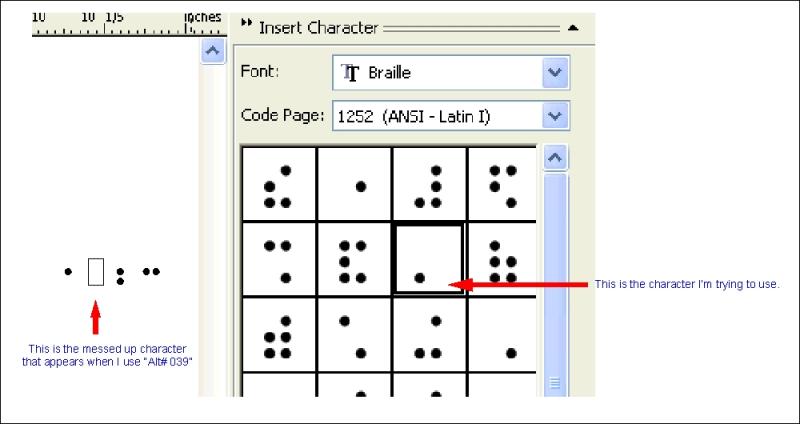

I've having some issues in Corel that just popped up with some special characters. I'm using Corel to enter braille, using a braille font. The special character I need is Alt.# 039, which is the double quote/apostrophe key.
I've used this for over a year now, no problems. Now, when I enter it hitting the apostrophe key, or using the Alt. #039, it gives me the rectangular box, indicating there is no such font for that combination.
I open up the character map and sure enough, it's Alt. 039 for sure. I've tried to use a different font (some other special character font) and I get the same thing when trying to input anything with that key, or that Alt. keystroke.
If you look at the "Insert Characters" map of it and click "Insert" on that item, it does the same thing, it displays the missing character symbol of a rectangle.

I do notice in the "Insert Character" docker that the "Code Page" had something odd selected. Any chance it's pulling off of some default language or alternate keyboard map or something? I've looked through the options pages and I can't locate anything that may indicate that.

Here's what it looks like :
