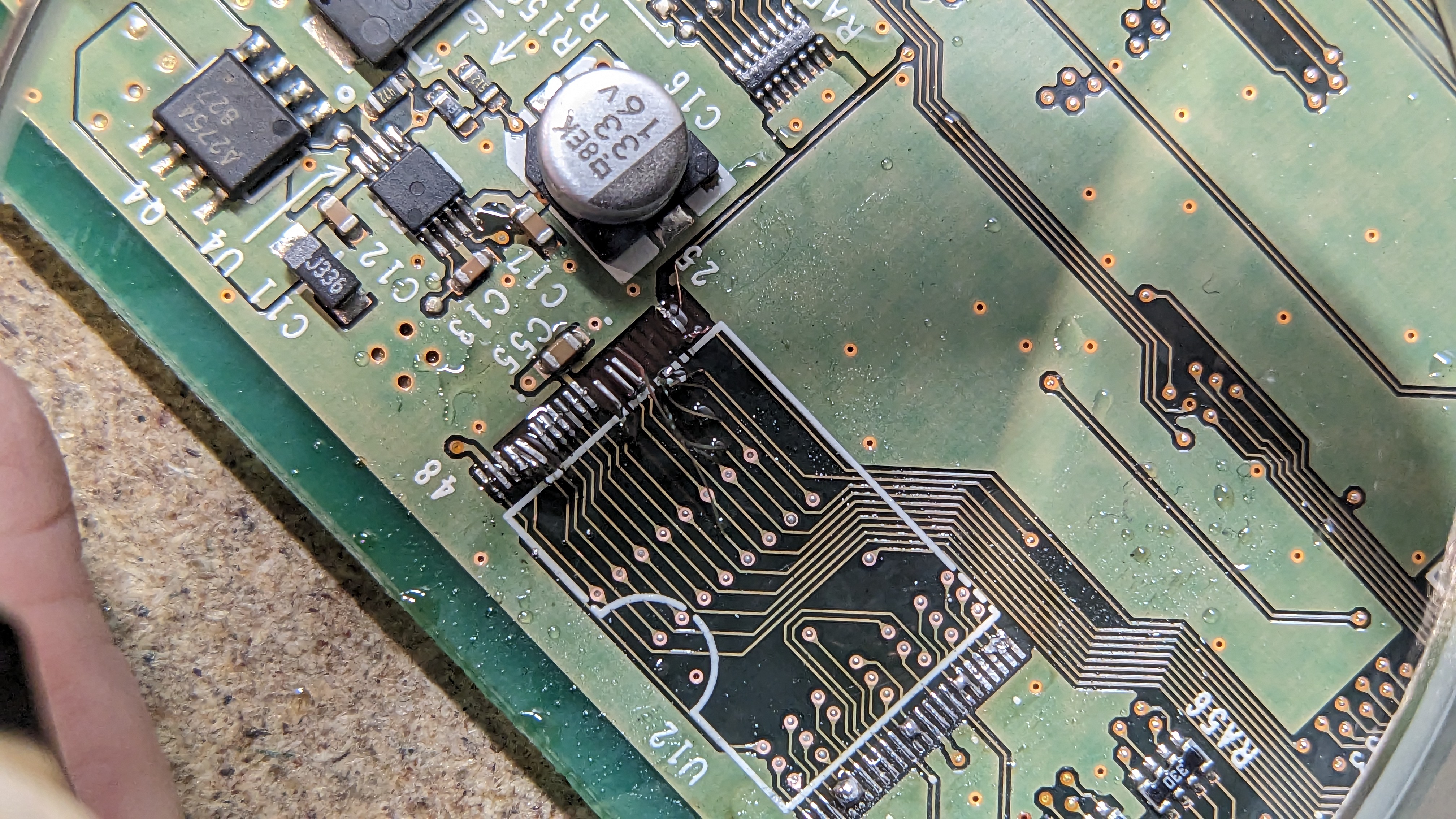

Yeah..... So this happened.
Smoke_Jaguar
Oof, not a good way to pull NAND. Fine pitch stuff is hell to desolder, sometimes the best bet is tapping on hookup wires and using that for your read. Might be fixable, but going to be rough.
