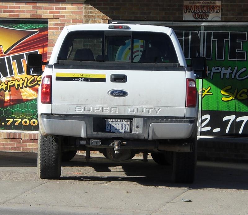

tailgate wrap on 2007 ford super duty pickup
i have read online that the ford emblems on the tailgate are very hard to get off and have small clips that can break easily?
i would prefer to leave it on, however if i do this how do i cut it out with out is showing white around it? lay tape on the emblem, then cut out slightly inside the emblem then lift it and then tuck?

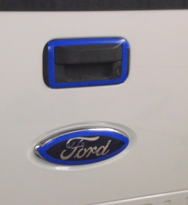

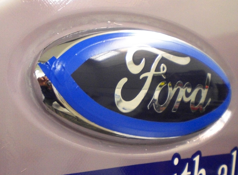

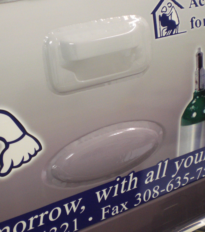

Spencer McMurtry
here are pictures of the process i used, if i was to-do it again i would of put the blue tape closer to the edges of the emblem.
