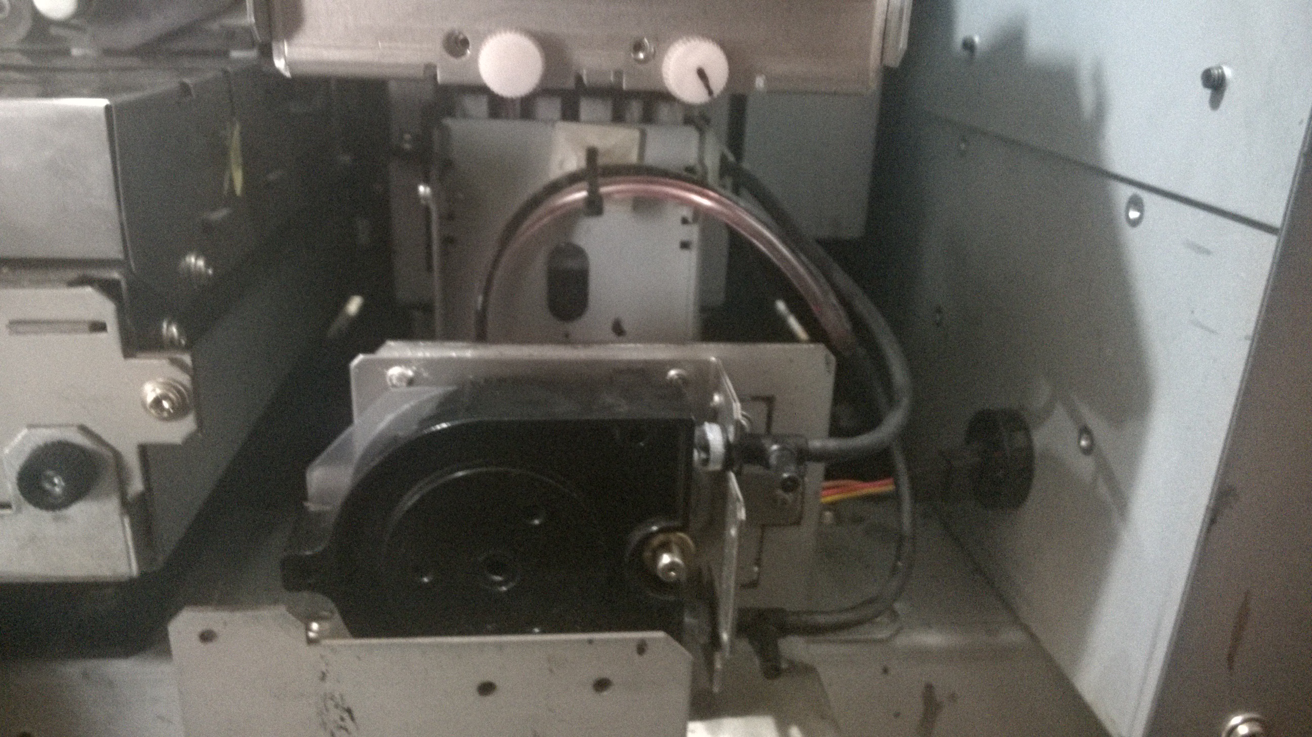

Hand851, Im curious about the hose from the pump out being out of the holder and needing to be above the cap base. Im not sure if mine is our or not. Pic attached.

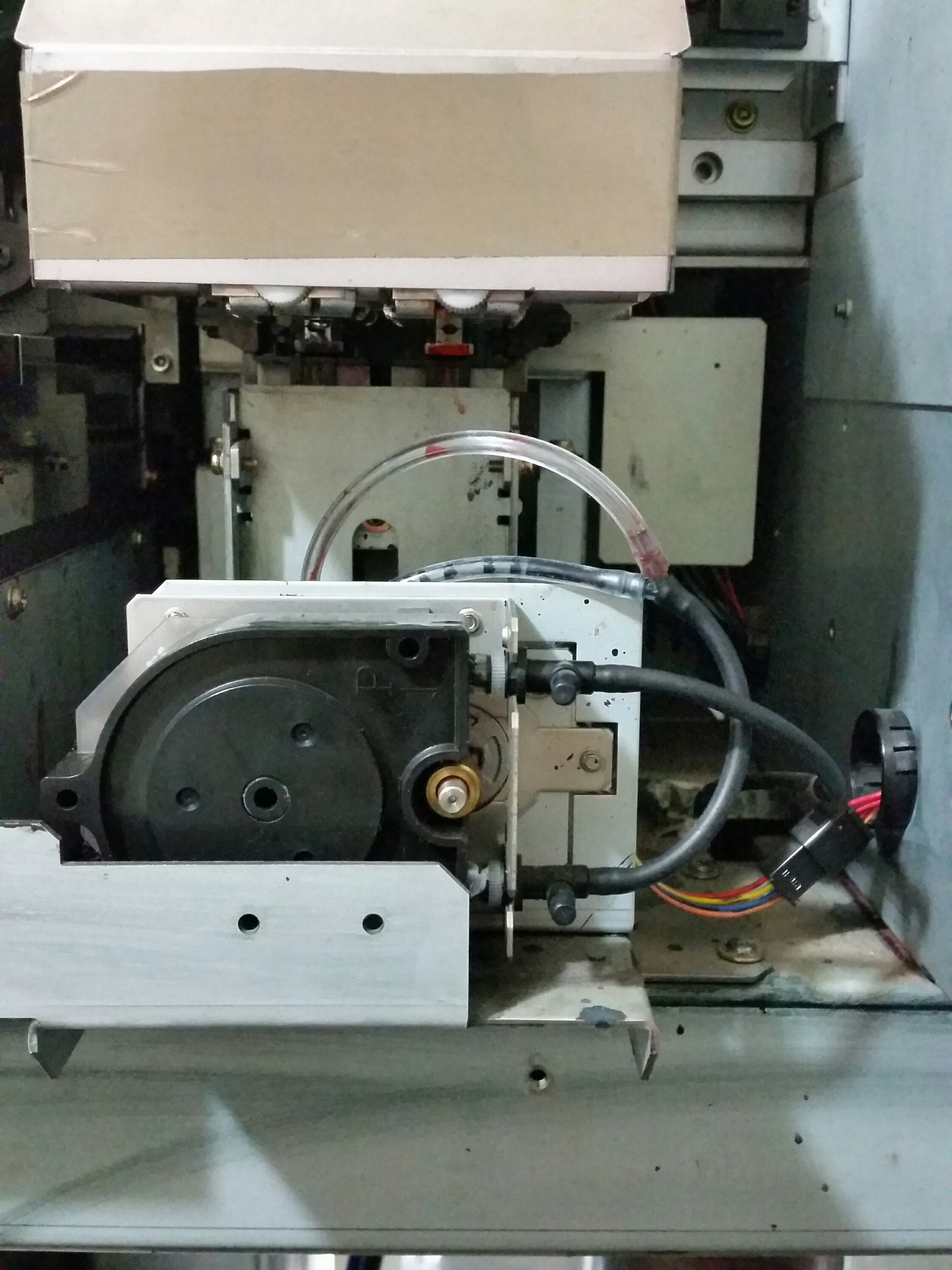

Pic attached

Aha! That's something I've never had on mine.. Thanks Terry01.
I think I've been lucky for the many years I've had this machine, till now.
