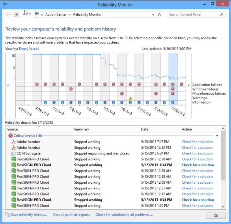

Flexi Cloud PRO has been crashing very frequently for me.
I used eye drop tool to change the color of 3 labels, and it crashed.
I used dimension tool and clicked on a corner of a text, and it crashed.
Sometimes, when I press Esc, it crashes, and other times, I press Ctrl+P, and it crashes.
I just spent 2 hours on a drawing and now I have to start from scratch.
Why does Flexi no longer offer to save files when it crashes? It has crashed hundreds of times, and yet only once did it tried to help me recover unsaved files.

VIP
Description
Faulting Application Path: C:\Program Files (x86)\SAi\SAi Production Suite Cloud\Program\app.exe
Problem signature
Problem Event Name: APPCRASH
Application Name: App.exe
Application Version: 10.0.0.1
Application Timestamp: 512fd5a6
Fault Module Name: FSUTIL.dll
Fault Module Version: 10.0.0.1
Fault Module Timestamp: 512fd11c
Exception Code: c0000005
Exception Offset: 000115d3
OS Version: 6.2.9200.2.0.0.256.48
Locale ID: 1033
Additional Information 1: 5861
Additional Information 2: 5861822e1919d7c014bbb064c64908b2
Additional Information 3: f3d5
Additional Information 4: f3d5be0cad2787556264647dc02181c3
Extra information about the problem
Bucket ID: 5a307396f6a39206b457b879d9568bd4 (-790061767)
Description
Problem signature
Problem Event Name: BEX
Fault Module Name: StackHash_65f1
Fault Module Version: 0.0.0.0
Fault Module Timestamp: 00000000
Exception Offset: PCH_D1_FROM_ntdll+0x00041318
Exception Data: 00000008
Locale ID: 1033
Additional Information 1: 65f1
Additional Information 2: 65f138fb72d3993088f67f23cc8b9991
Additional Information 3: 738e
Additional Information 4: 738e8bb5d59ed581d536f7f6af3c5349
Bucket ID: ee3a5d5f3456f22e4fa80801cfb5c776 (-663557869)
Description
Problem signature
Fault Module Name: ntdll.dll
Fault Module Version: 6.2.9200.16420
Fault Module Timestamp: 505aaa82
Exception Code: c0150010
Exception Offset: 0007df5e
Locale ID: 1033
Additional Information 1: 56d8
Additional Information 2: 56d8bd8767d12aac29207c6133c3608f
Additional Information 3: e6d7
Additional Information 4: e6d79a34489d2a07043526411e292a9f
S11930
Thank you very much, i thought i was the only one with crashes
There is no warning. if you have multiple windows open you lose it all. it dose'nt matter if you save it every 5 minutes or every 5 seconds you still have to remember which project you were on before it crashed and hope you remember to fix any thing else you were working on. Ive sent multiple reports like the the ones you've attached but no response yet. It really is a pain i hope they resolve it on the next set of patches due out real soon.
