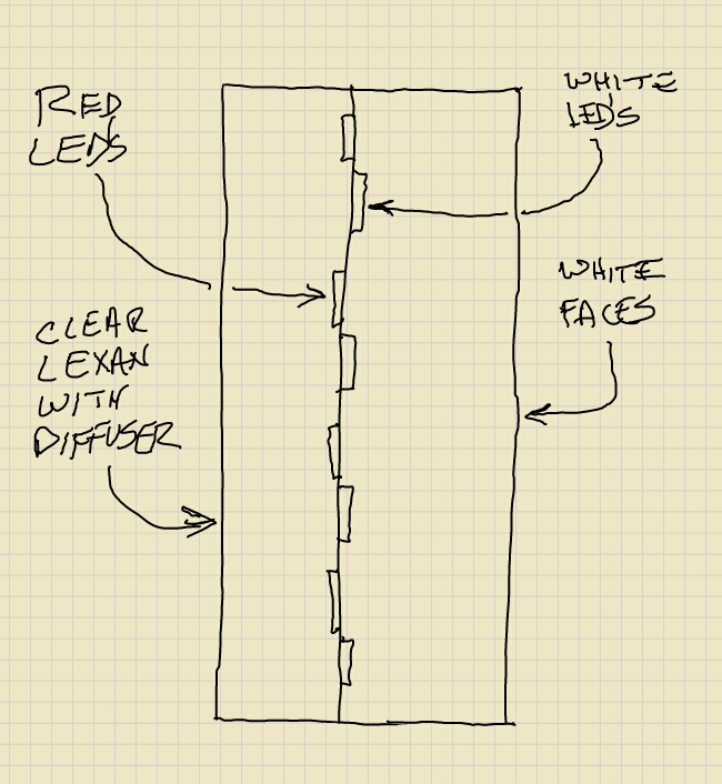

Here's a crappy quickie drawing of what I was saying:
Moze
No, 5" coil is still fine but you'll need to put your white LED's closer together to avoid hot spots.
You can use aluminum or ACM for your divider and locate it approximately 1½" from the back of the returns. That gives the front LED's 3½" to spread out their light and the back LED's 1½", which is fine since the halo lighting doesn't need to be dissipated quite as much.

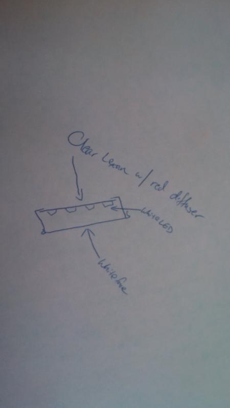

FYI (i'll raise you one sh*ttier sketch!) this is what I was hoping would work. Other option may be budget buster for customer.
J Hill Designs
I cannot see the red bouncing back off the wall, back through the back panel, past the LED's, to create any pink in the white face
I've estimated a ton of these. I've never manufactured them. I have never estimated them the way you drew it. It doesn't mean it won't work, but it's not how they were built where I used to work. It seems like that would be a really flimsy letter with only acrylic faces/backs to stiffen them up.
Personally, I would manufacture them using 5" coil and a divider.

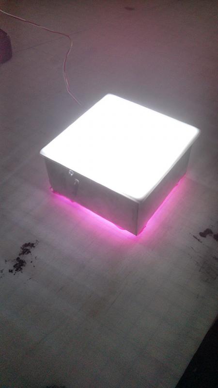

Sorry i cant find any pictures of this lighting,looks good though. 5" can white faces clear backs with green diffuser. Just do an experiment and see if its what you want

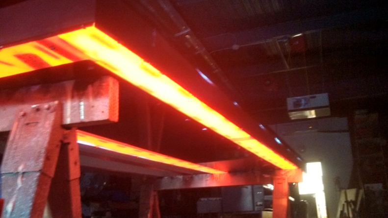

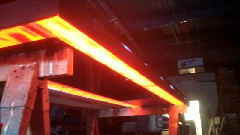

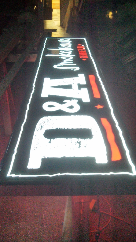

Aaaaand we're done! Should be going out for install on Friday but it looks aweseome!!

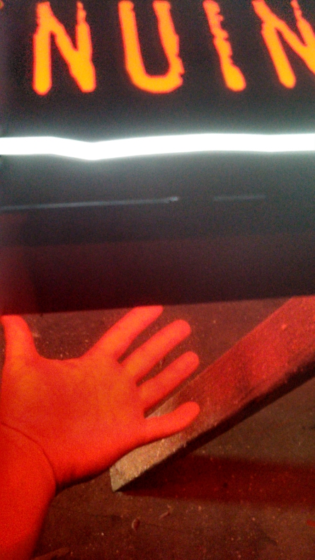

Just took some crappy cell phone pics in the shop but I think you can get the idea. All the reds are very deep, even though the camera turned them orangish...
