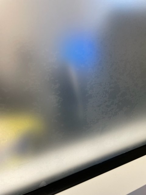

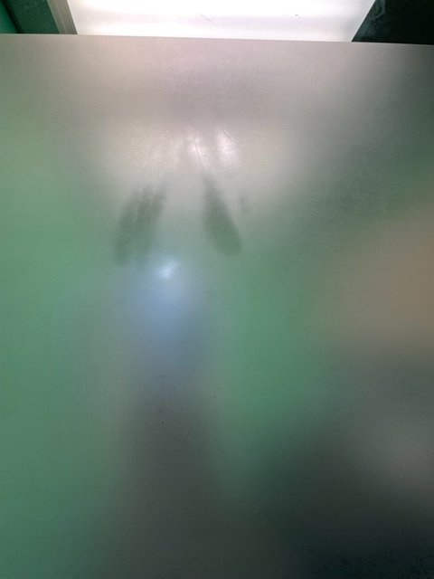

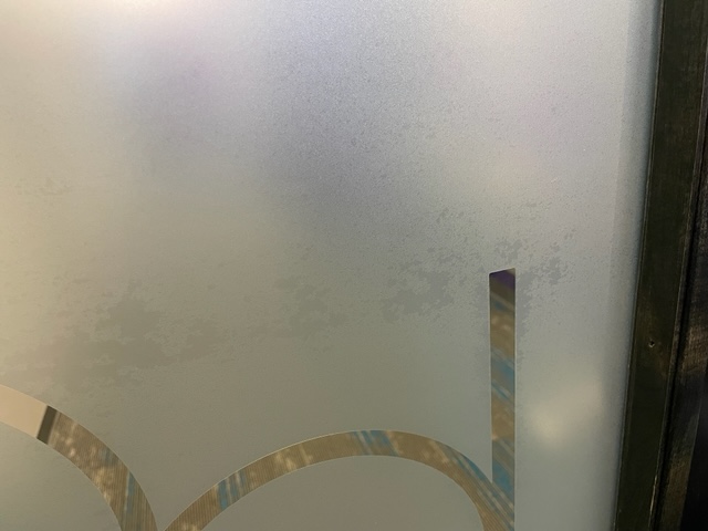

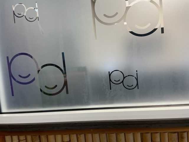

Like the title says. Pictures included. The vinyl was installed December 8th (22 days ago) so it isn't an issue of curing/settling. I don't know yet what my installer used to clean the glass and/or if he tried to do a wet app but I figured I'd post this here anyways and see if any experts could tell me what went wrong. Will update with new info when/if I get it. This is a large reception window we did for them but the client said it is also present in the doors we did. We are getting to the end of the roll so I was wondering if that might be a factor.
Edit: Apparently he used water and baby soap. Is this why this is happening? I've done wet apps with application fluid with the same air egress frosted vinyl before and it adhered perfectly and without any patches like this.
