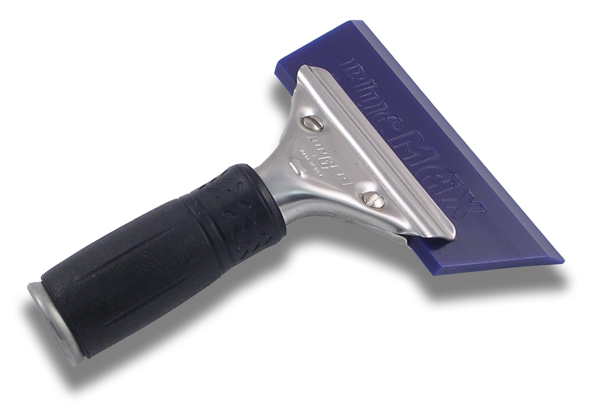

You can cut this just like any other vinyl. As far as application, if you read the product installation sheet they recommend wet application. If you are applying something that is small and not covering much of the window a dry application would work. As far as application fluid, I have had better results with a mixture of water and Johnson's baby shampoo ( 1 teaspoon of baby shampoo to 32 oz of water) then rapidtac or soap/water mixture. It doesn't leave a residue under the film when it dries and was recommended to me by 3M Install trainers. Also, if you are applying a large piece, use a Blue-Max Squeegee and wet the surface of the transfer paper to allow it to slide easier when squeegeeing.
http://www.orafol.com/tl_files/cont...tructions/en/Information_PlotterMaterials.pdf
I have personally found this oracal easier to install then 3M dusted crystal and I would recommend using it.
