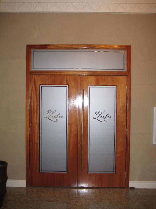

I prefer the softer look of etched. You can apply it wet or dry.
