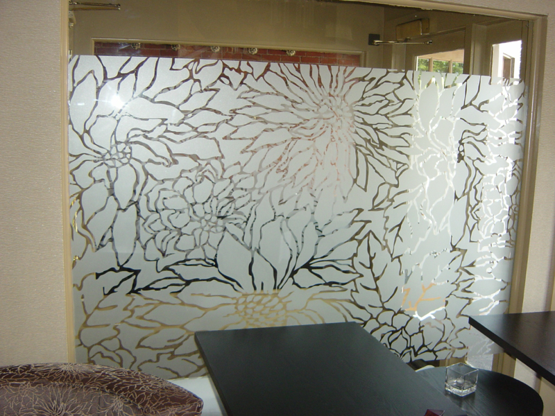

Frosted window film with intricate design installation
J Hill Designs
if its full bleed reverse cut graphics - wet all the way
did 10 of these - 5 hours on-site - wouldn't have even attempted dry

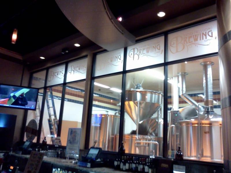

demandattention
Lay it down wet and heat up the transfer tape to help dry. It may take a while to dry but it'll come out perfect .
