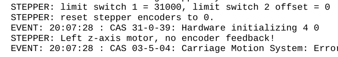

Your left z-axis motor cause the issue. Try turning both of them to move carriage up and down easily. Could be motor problem or it’s control board.

Sometimes the motor spindle breaks or carriage is under an angle blocking movement or one of the z-home sensors is damaged

Looks like a problem with the linear carriage motor or encoder. Difficult to diagnose without the SDS key.
