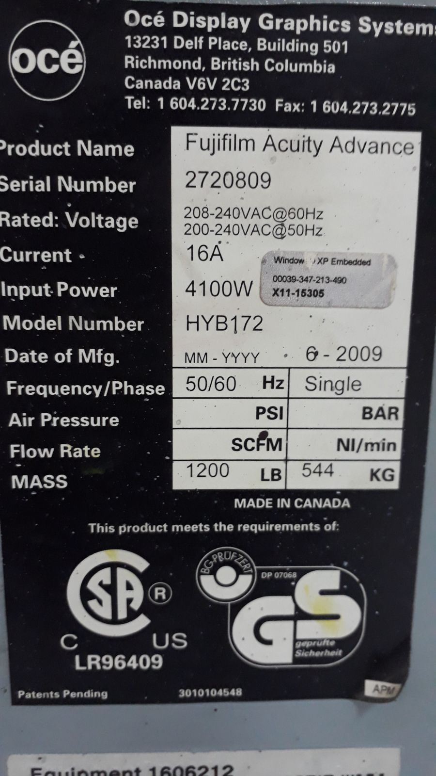

Thank you very much for your replay. Please check the attached file of printer sticker
