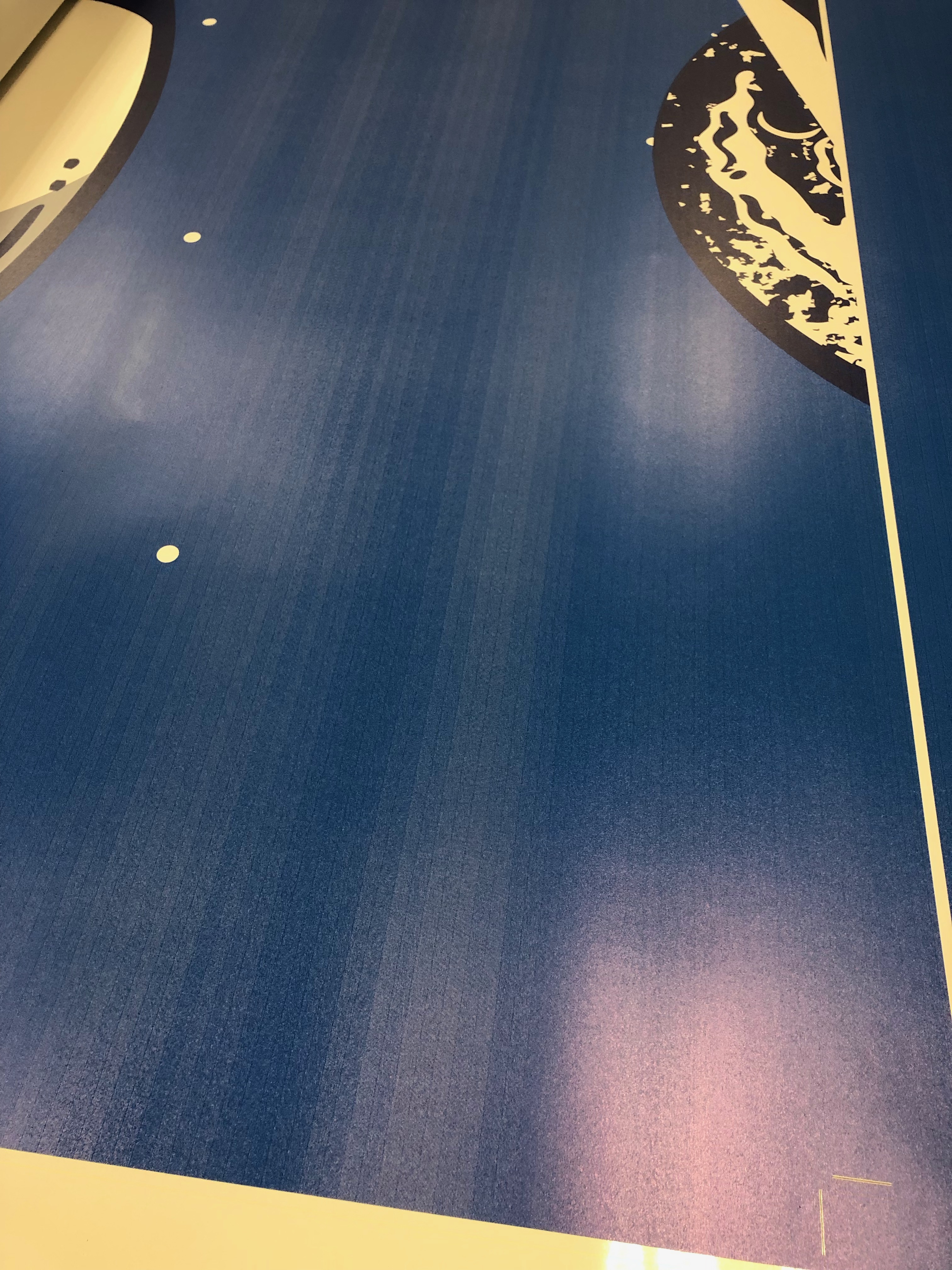

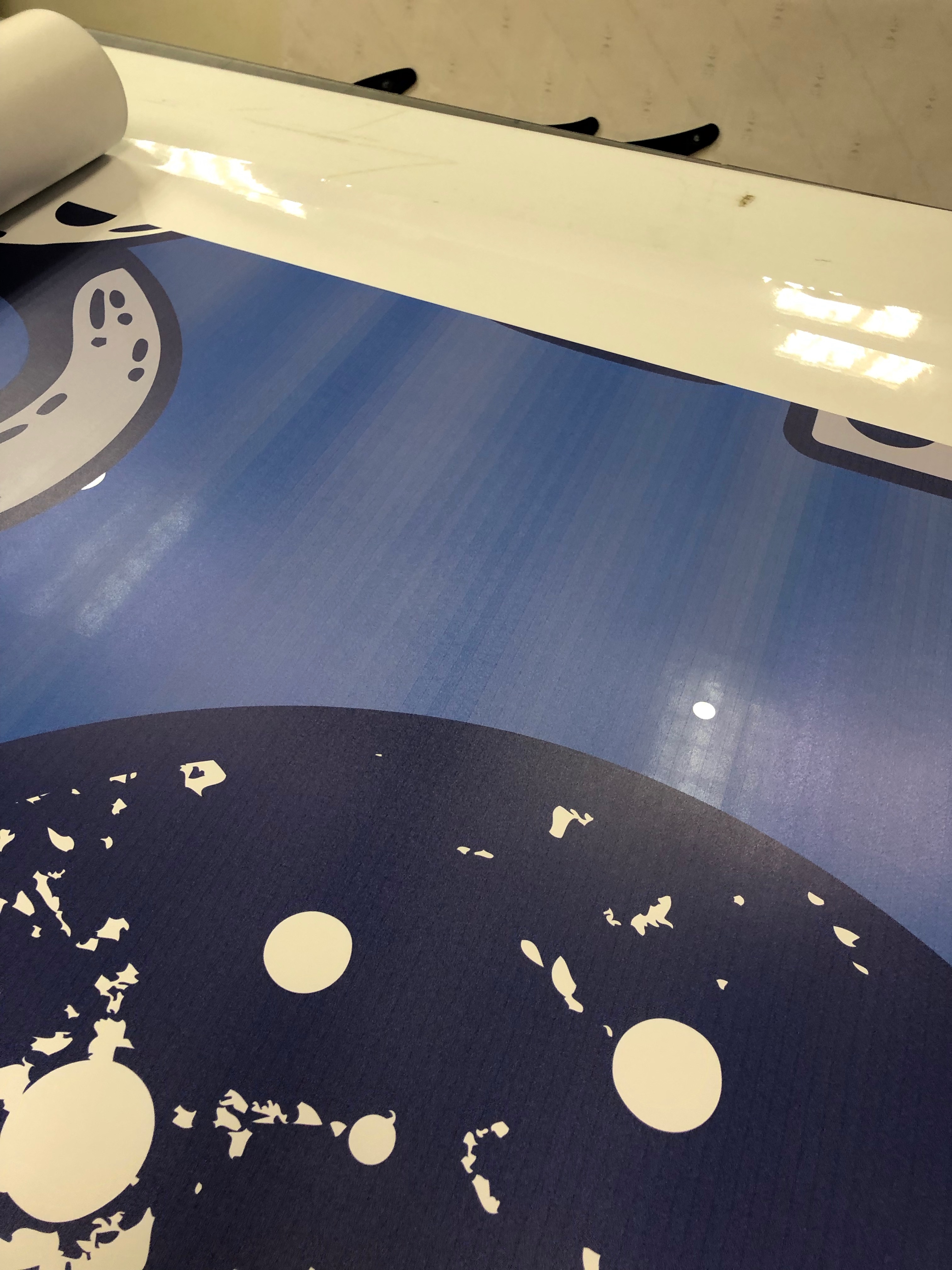

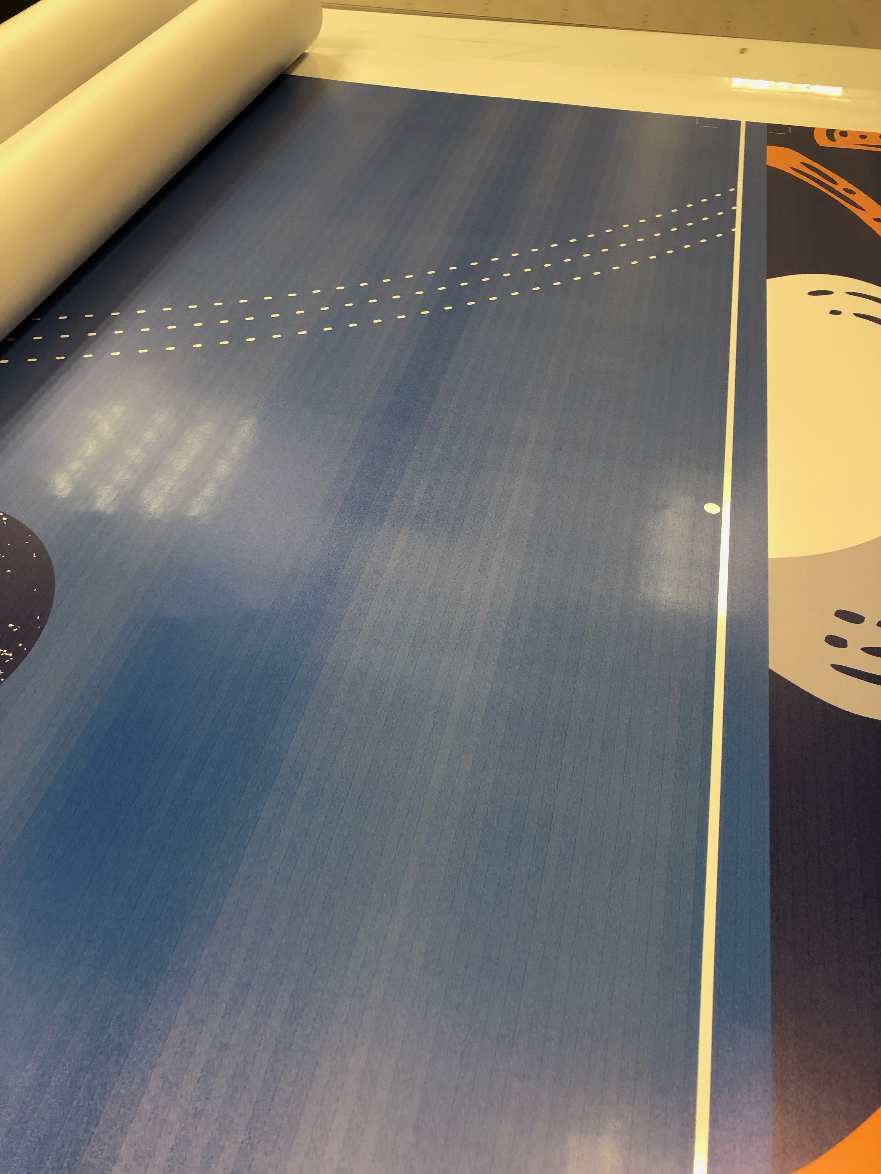

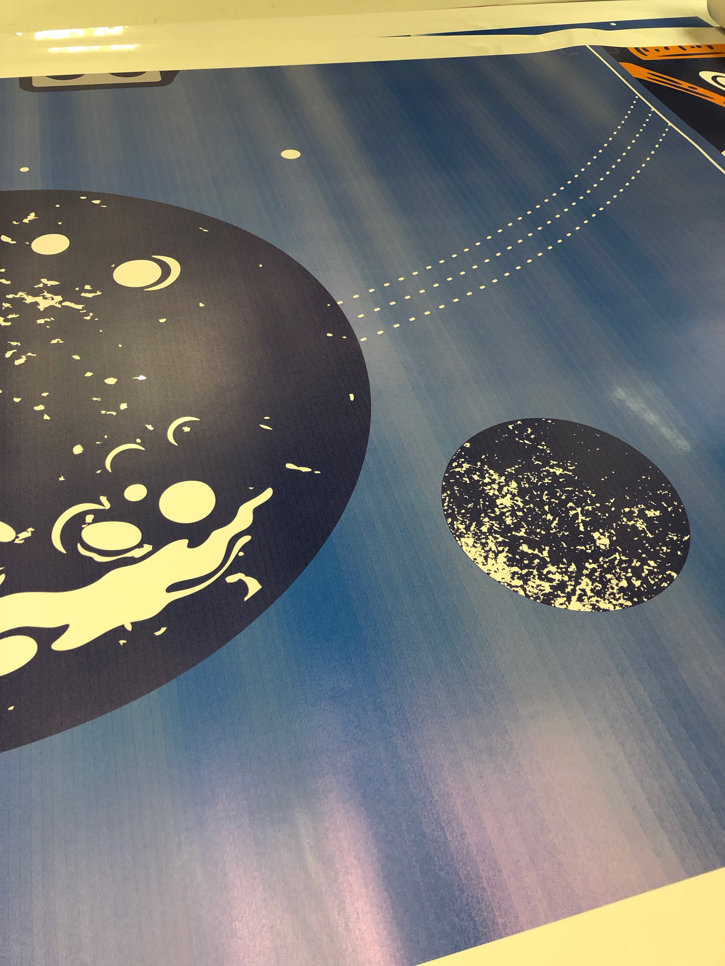

Using Colorgate, which was supplied with the printer. I run Caldera (Version 11) for my other printers and had tried it but the only profile I could get was using about 30-40% more ink than the Colorgate profiles. If you can tell me where I could get some profiles, I would really appreciate it. Fuji are no help and there is nothing on Caldera's Workspace.
Here are some pics of the issue
