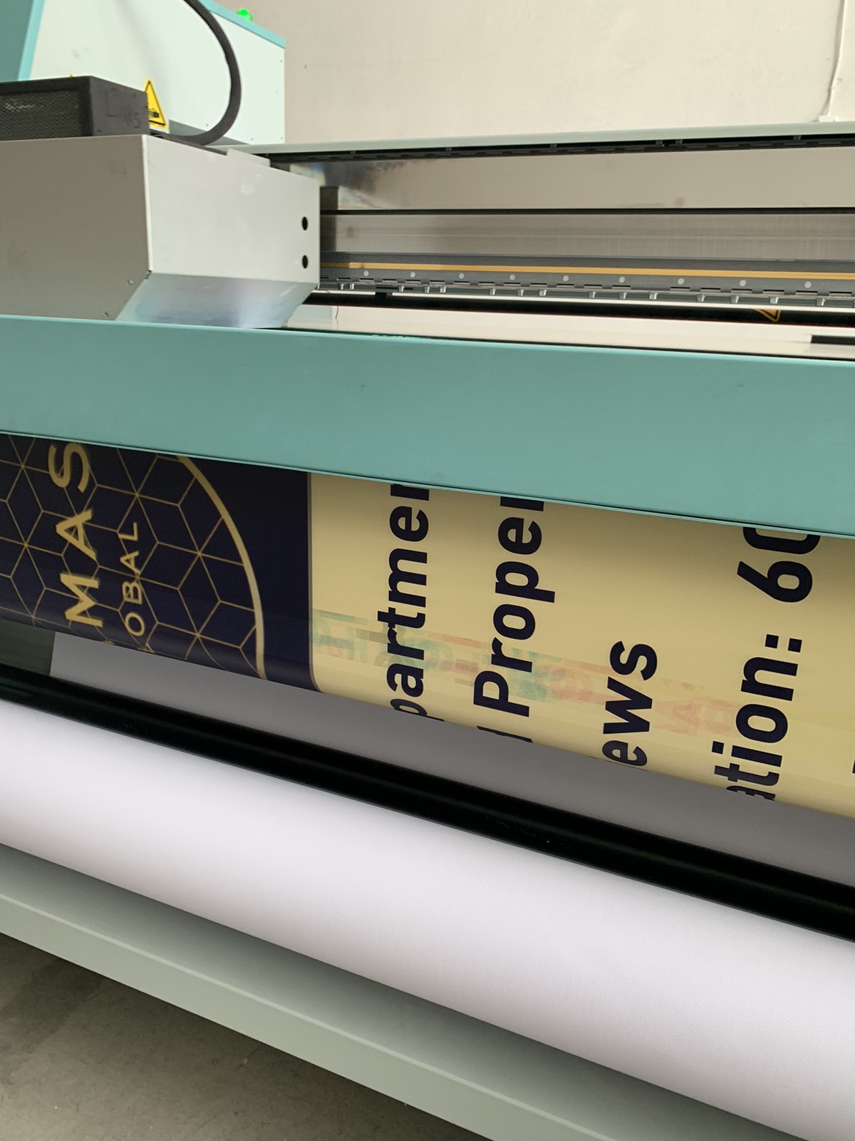

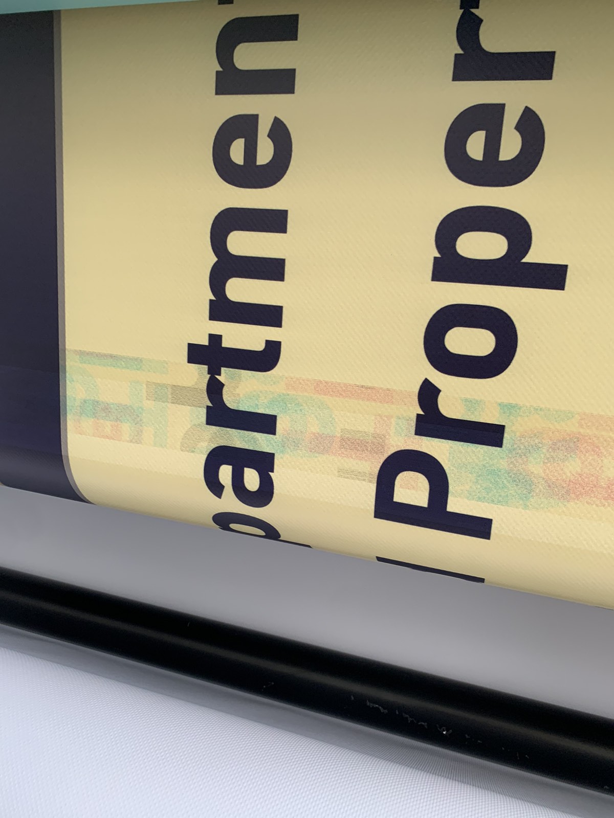

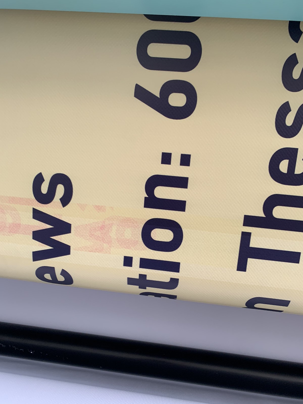

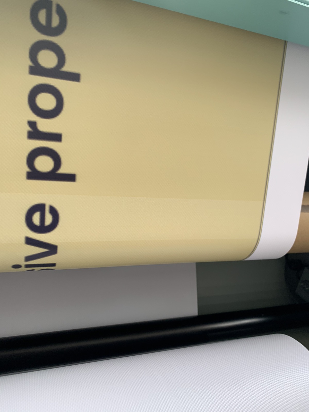

Hello , my uv flatbed printer does some weird overprinting when im printing big dimension jobs.
Does anyone know what can that be? Im attaching some photos

Could be the FireWire cables that goes from the PC to the heads
If we're talking about the same thing, it doesn't look like an overprint. Perhaps if you indicate the defect in the photo, if you describe exactly under what conditions it occurs, we will be able to help.
Give more information.
ToTo
Professional Support
I would also go for the firewire cable which is transferring the data from the datarelay to the carriage pba. If you could provide the machine logs it can easily be checked.
Dimepigrafes
It occurs at random times, i've checked that and with different files , so it's also not a file problem.I've got a new firewire cable so im gonna test this,thanks!
