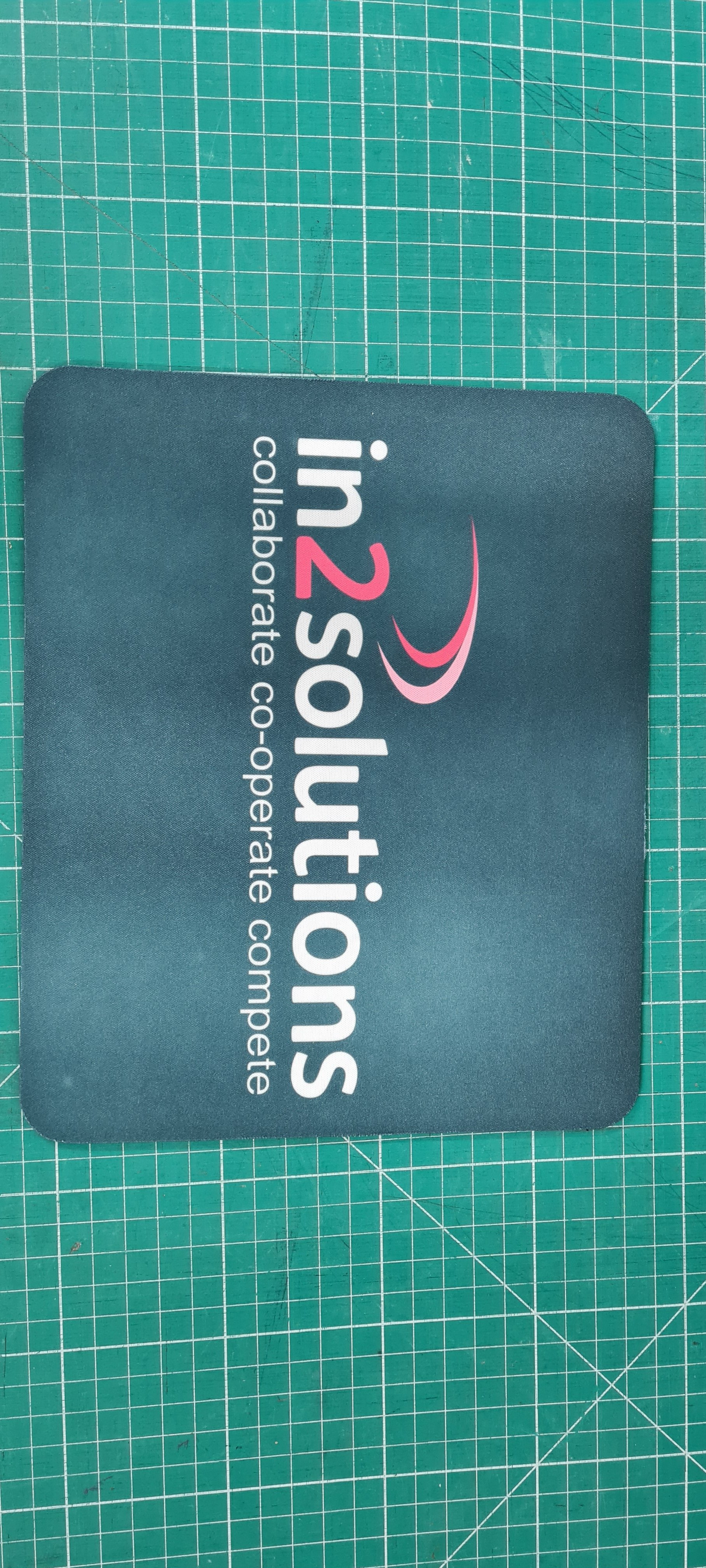

I'm trying to print a design on a white mouse pad 3mm thick fabric.
There is a lot of black as you can see from the images but the black is very patchy and the black isn't very deep in tone, it's a little on the light side.
I'm wondering if this is a heat press issue, not having an even temp across the plate or something else.

May sound silly, but the paper is on the top correct? I use epson paper/inks and never have an issue, but that looks heat related to me.
