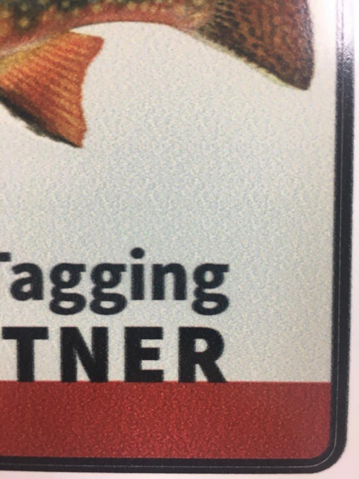

My 3rd print head was replaced yesterday, the tech did all of the calibrations but now all of my prints have a grainy fuzziness to them. I have tried several different profiles that I usually use to no avail. The test print is perfect.
Anyone have any ideas as to what would cause this, or a possible fix?
I showed it to the tech and he said he didn't know, and he would ask around. I don't really have time to wait.
Solventinkjet
DIY Printer Fixing Guide
Yeah that's alignment issues for sure. It's so bad I might even think the head is physically out of alignment and not just the bi-directional.
Dr. Decal
The tech just came back by. He made a few more adjustments, and the prints are acceptable now. There is still some fuzziness in solid color areas though, and he took samples to try and figure out the problem. Physical head alignment could be the issue considering 3/4 have been replaced.

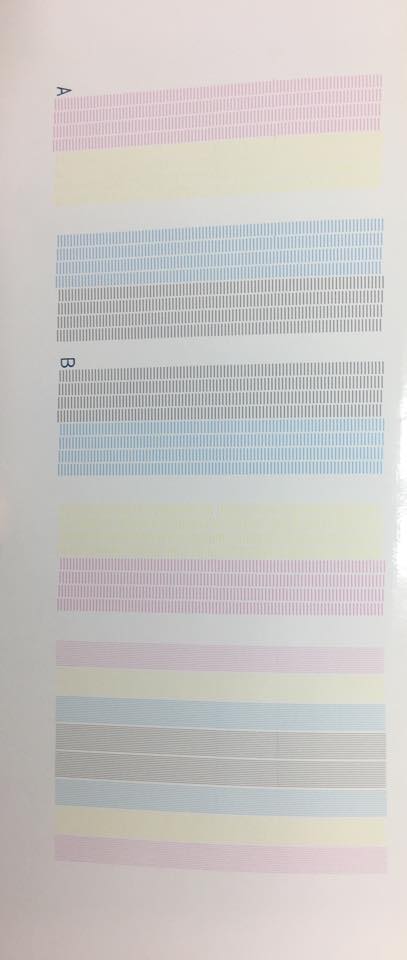

What does your nozzle test look like? Easy to tell if bias is off by what the nozzle test looks like. Assuming your tech did everything right this time around maybe something as stupid as static is causing the lingering fuzziness
