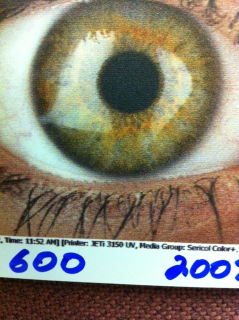

This is 1/16th" text below the eyeball. 300x600 200Density
bidirectional. I don't try print anything smaller.

Also if its a RICH color you are running, you have a better chance of misalignment between the different head colors....single color black Much easier to align in that case.

Scott, can you rip color replace the gray from a 6 color gray to only a % of black. At that size the color shift will be minimal.

I forget what test pattern it is where you can evaluate them, but you might want to tweak your head voltages, they tend to get a sort of a blurry effect when they are out and it makes a big difference. Also have you tried force_dpi_x 600 force_dpi_y 1200 and a snapkill and restart from the console? You could also manually up the pass count past 24 and slow it way down.
