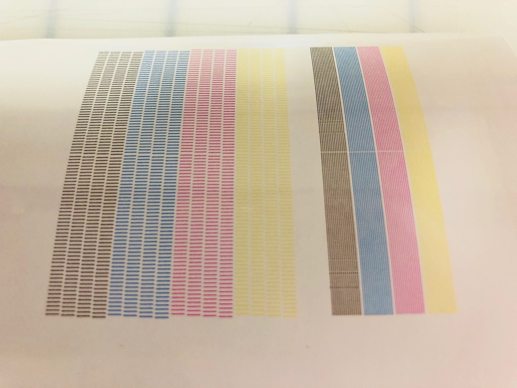

I noticed some major streaks in a print yesterday so I did a test print. Had some magenta in my yellow. It's probably been years since I replaced a cap tops so figured it was time. Replaced both cap tops and color went back to normal. But noticed between passes on a test print there is a very small gap. Can't find anywhere how to calibrate that in the service manual. Any suggestions?

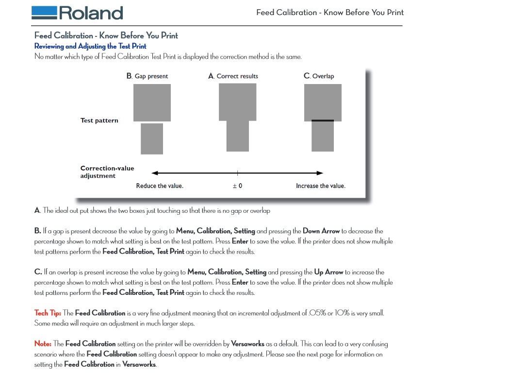

That isnt a service menu item. In your menu go down 3(i think) clicks and you'll see CALIBRATION. Do the test print and enter the value that results in the 2 black boxes touching perfectly.
Your value is too high and needs to go lower.

In Versaworks, under printer controls, there's a drop box under feed calibrations controls, you can change it to use printer settings. The adjustment is made at the printer though like everyone else said, menu > calibration > test print, pick the value with no gap or overlap and select and enter the value under settings.
