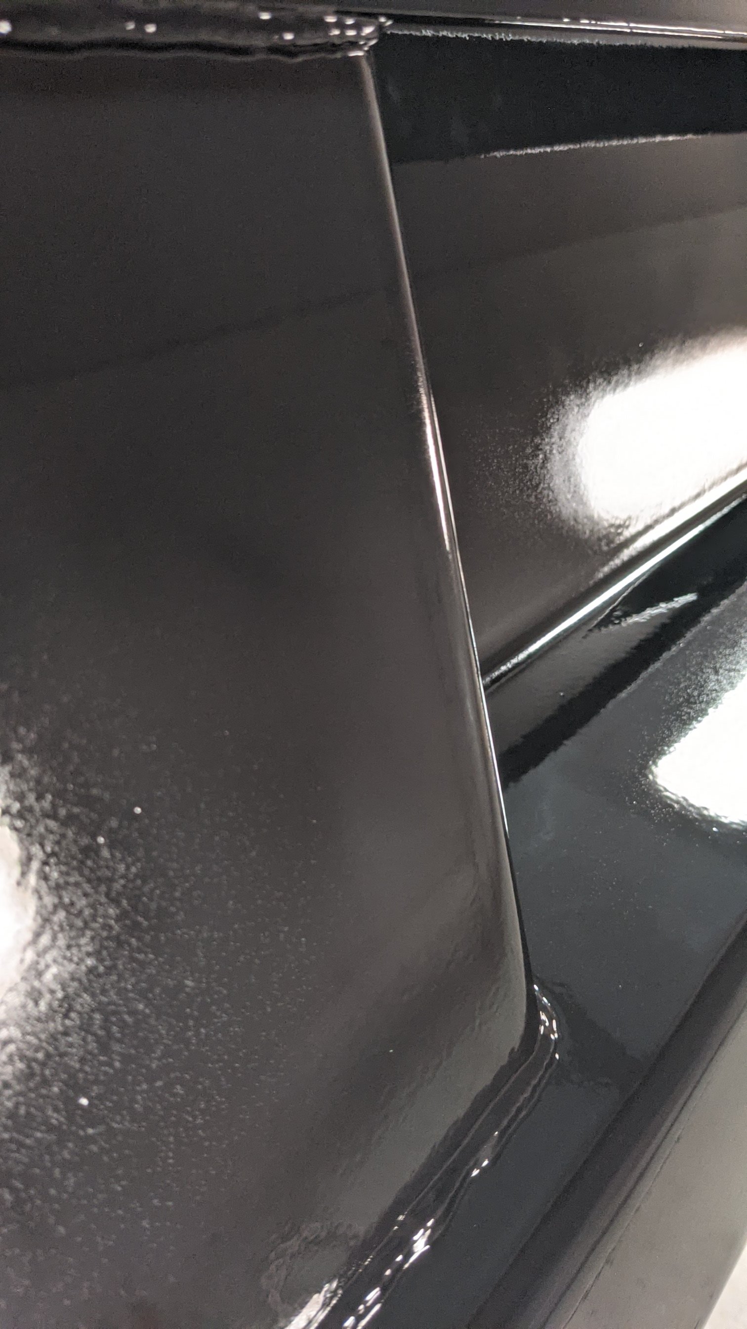

We do in house metal fab, when we dip our products in paint you have to wait 24 hours before doing a second dip... If you don't the first layer offgasses and causes a lot of bubbling. We use a fast dry enamel paint - https://industrial.sherwin-williams...-fast-dry-metal-finishing-enamel.9170954.html
We have a guy who dips 8 hours a day, everyday - tried diff paints by all the major brands... Every single brand will bubble if you re-dip the same day, even though it's dry to the touch in under an hour.
We also have a Mathews paint spray booth... And it's the same thing. If you.spray more than 2 coat before their recommended offgas time... A term they again use, it causes bubbles.
Weve also been screenprinting for 30+ years.... And screen printing ink is similar. If you paint plywood white you can't just screen it the next day or the print will start to bubble from offgassing, some paints like enamels are the same... It takes 3 days for enamel ink to cure enough before you can do a second color or it'll bubble badly (there are ways around it like a heatgun... And it depends on if it's full coverage / etc). On e we started waiting a few days after painting plywood we've never had a bubble issue again - and the only time we ever have one is when we're in a rush and screen the next day. It doesn't happen everytime... But waiting has eliminated it completely.

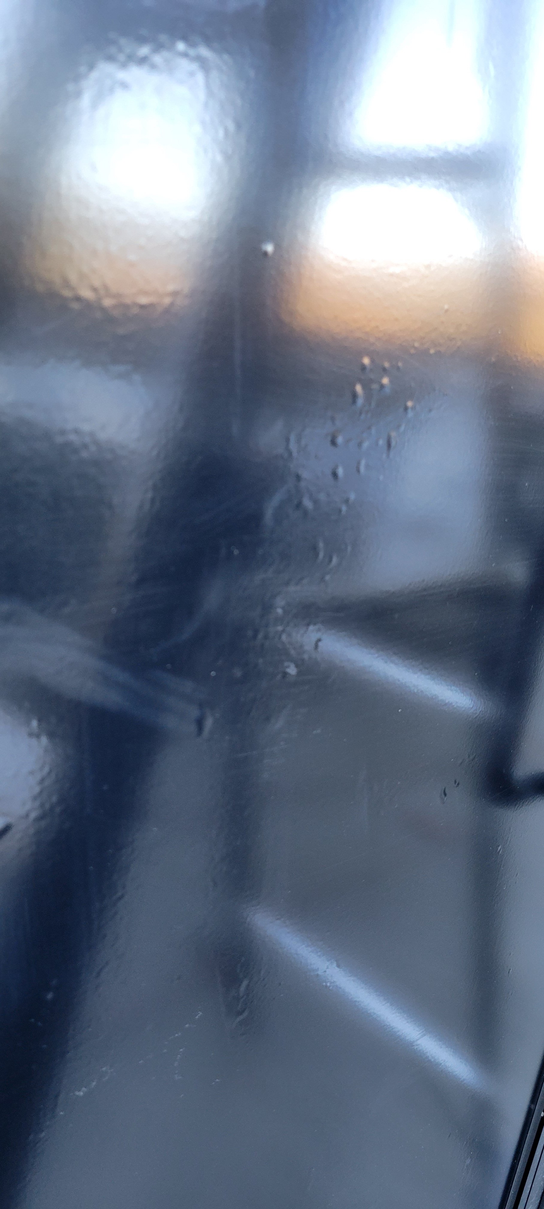

Here is the mysterious "off gassing" Aka solvent pop. It's 92% humidity and low 70s here right now which is why we got it. Job will still fly. Bet I could go stick vinyl over it right now and it wouldn't do a thing. For all the talk about it here, I've yet to see a definitive example of it actually happening on vinyl.

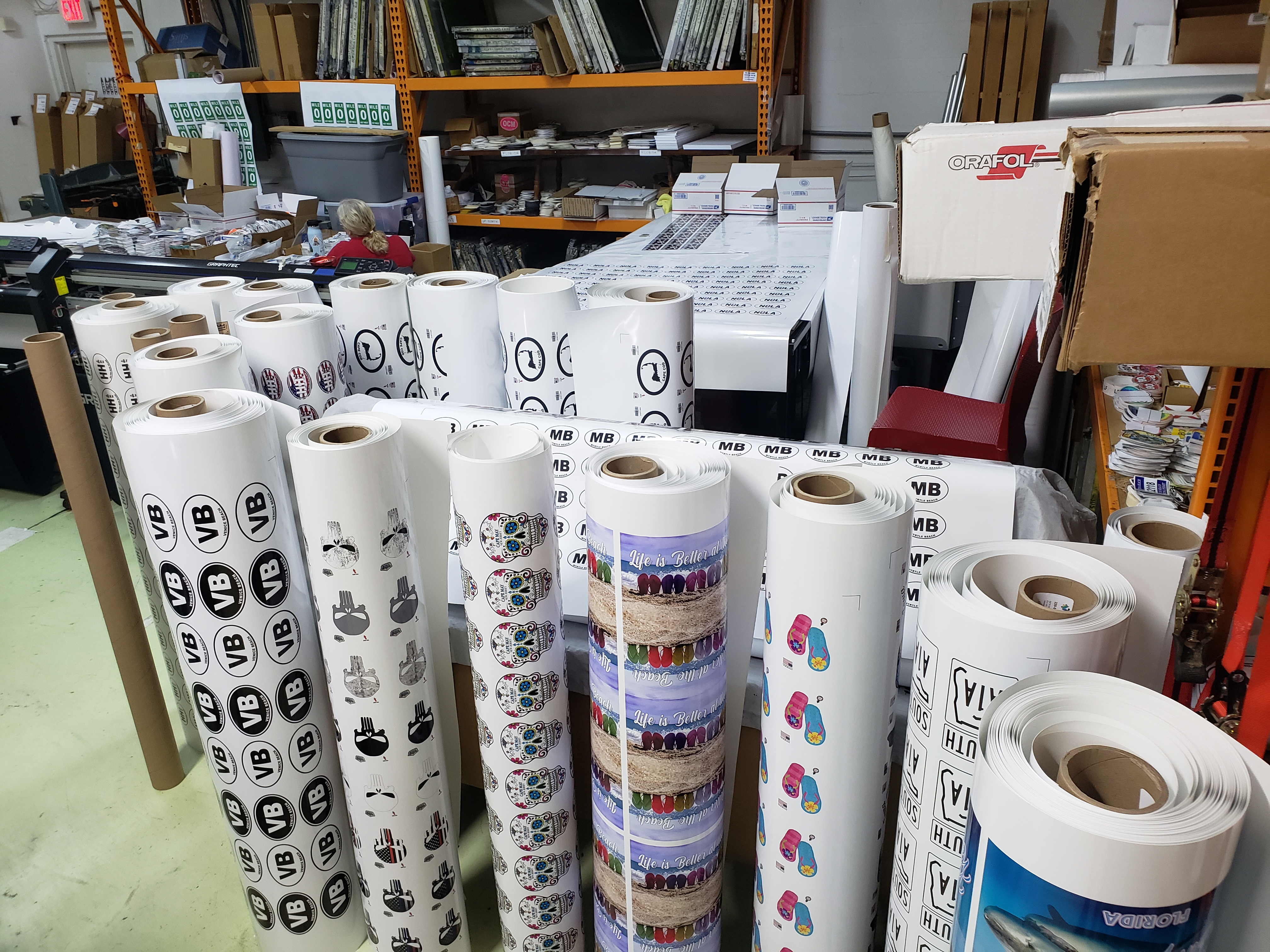

Multiple Box fans layed flat overs 2x4’s blowing up on slow setting.
Vinyl prints to be loosely rolled and set on top vertically.

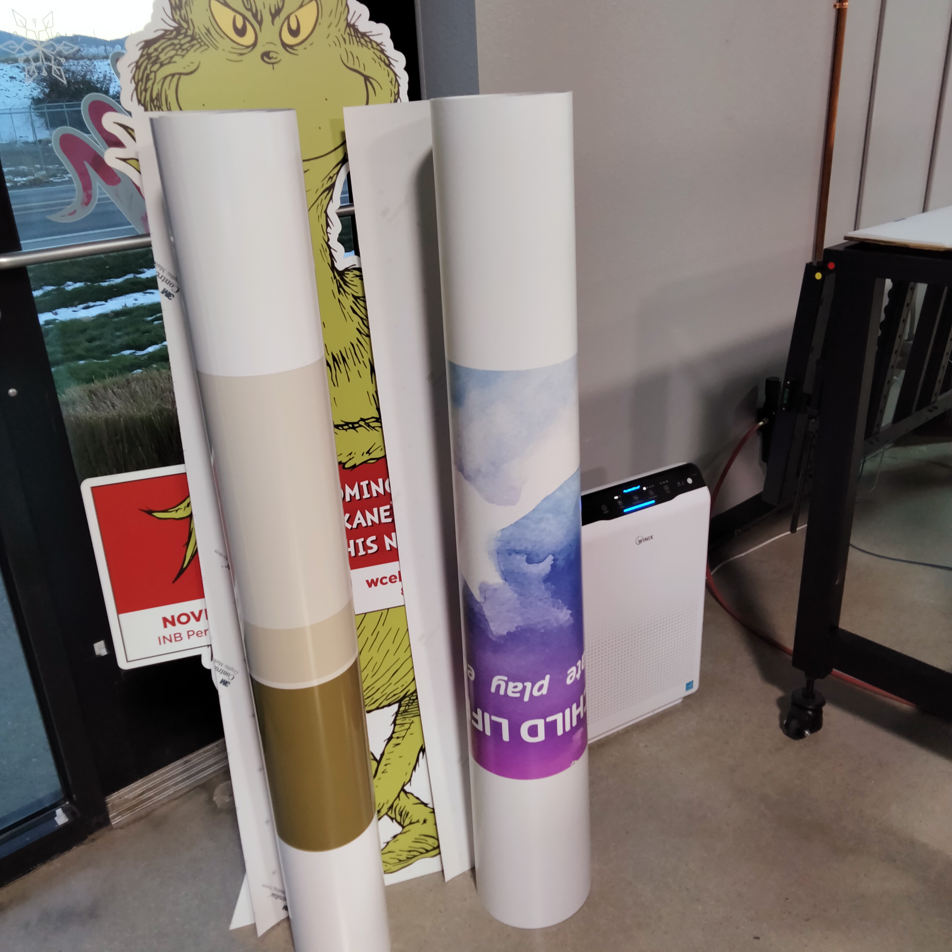

What I print today I laminate if needed and cut tomorrow.
After printing I loosely fluff the roll over night.
If you can smell a strong odor from the ink don't laminate or cut yet

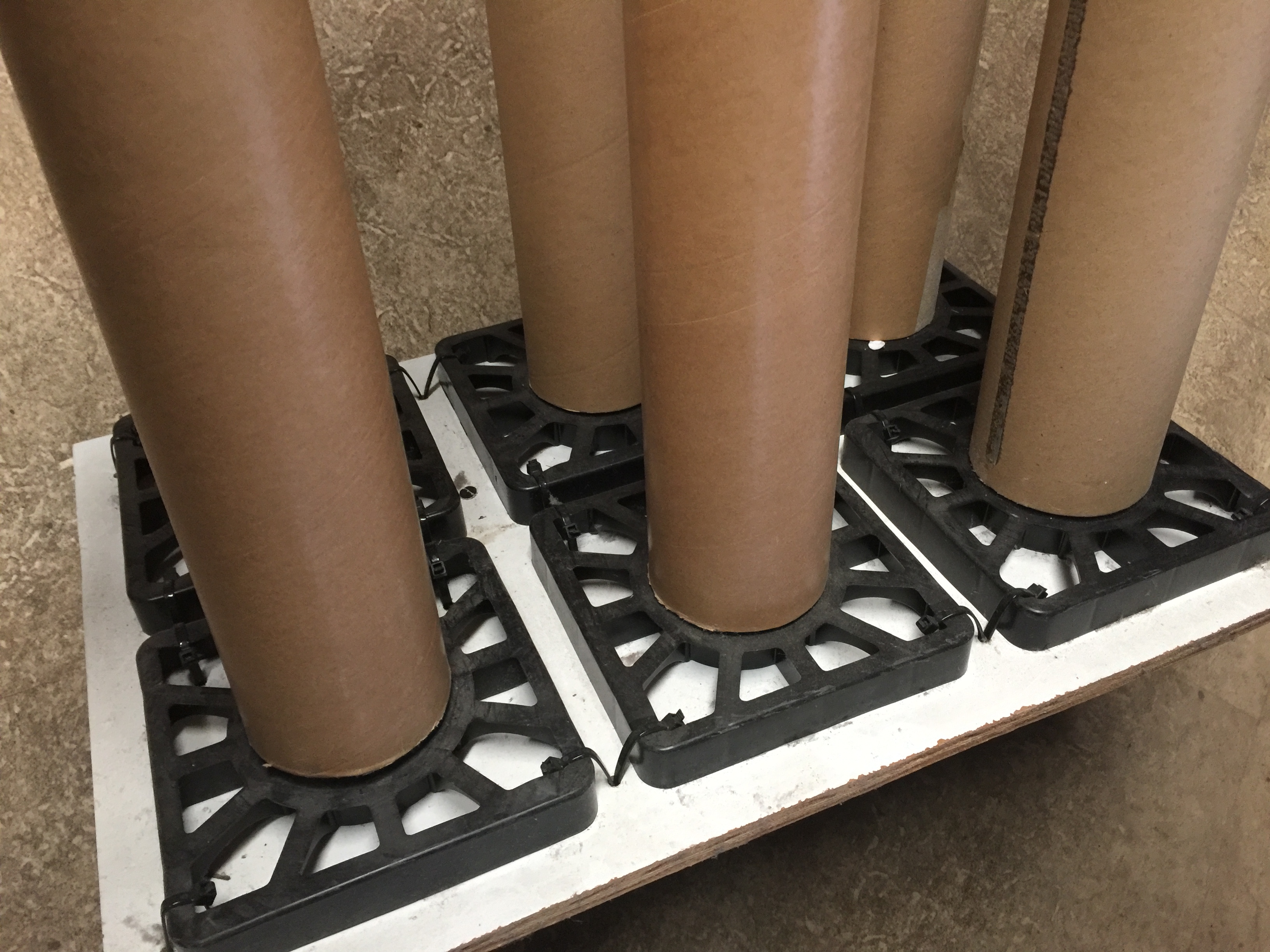

We use a Yellotools boost box bucket to off gas our prints. They say you can get 24 hours worth of off gassing in 4 hours. We haven’t had any issues from using this method.

The reason that the airflow needs to go out the bottom of the rolls/box is that solvents are heavier than regular air, so they want to go downwards. Loosen the rolls up as much as you can and put it into the box, it definitely makes a difference; leaving it tightly rolled overnight just traps the solvents between layers and doesn't help anything.
